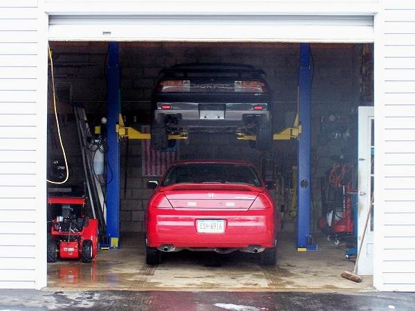

You are really going to have to do a layout on paper of what you want. I know that 26' deep is enough room for a double cab dually and just enough space to walk around one end of it. I know that 24" wide is enough for 2 cars side by side but not enough room to open the doors fully. I know 11'6'' is enough height for a 2 post lift if it's positioned between 2 trusses. These were garages that were already built and I made do.
