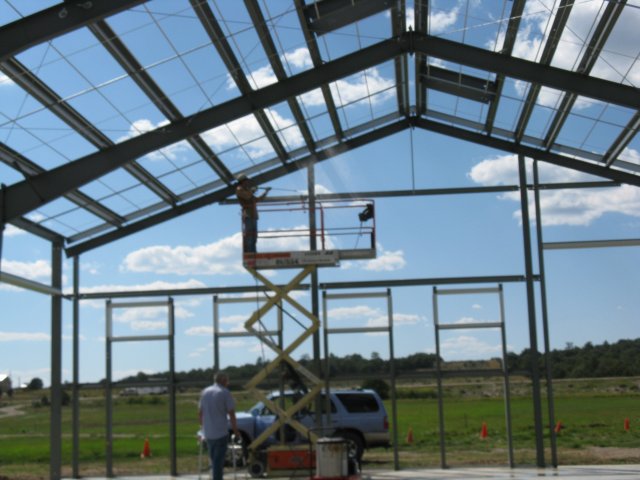

They are one reason I abandoned my initial idea about having a more open and airy design, should global warming make those critters eventually come over here. Well, that and snow. IMG_2805.jpg

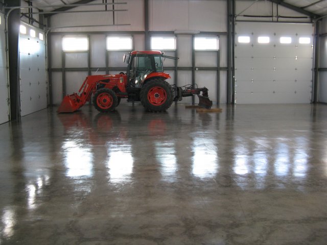

Decided to sacrifice some some of the natural lighting and went with a roof, walls, and higher windows instead. IMG_2915.jpg

They are one reason I abandoned my initial idea about having a more open and airy design, should global warming make those critters eventually come over here. Well, that and snow. View attachment 100179
Decided to sacrifice some some of the natural lighting and went with a roof, walls, and higher windows instead. View attachment 100180
Man, now that’s a pole building!
