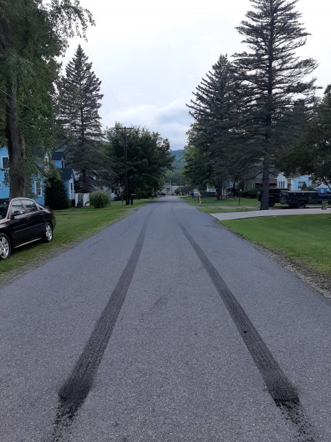

Good news is my line lock works. Haha. Isnt this how you take tire stickers off?
These things turn right into goo. Sticky as all hell. 40 roll and all you hear is the stock carrier bearing begging for mercy and you're flat gone. Zero vibrations to 140 mph. Kudos to Paul at PK Auto for the bundle deal plus mount/balance.
