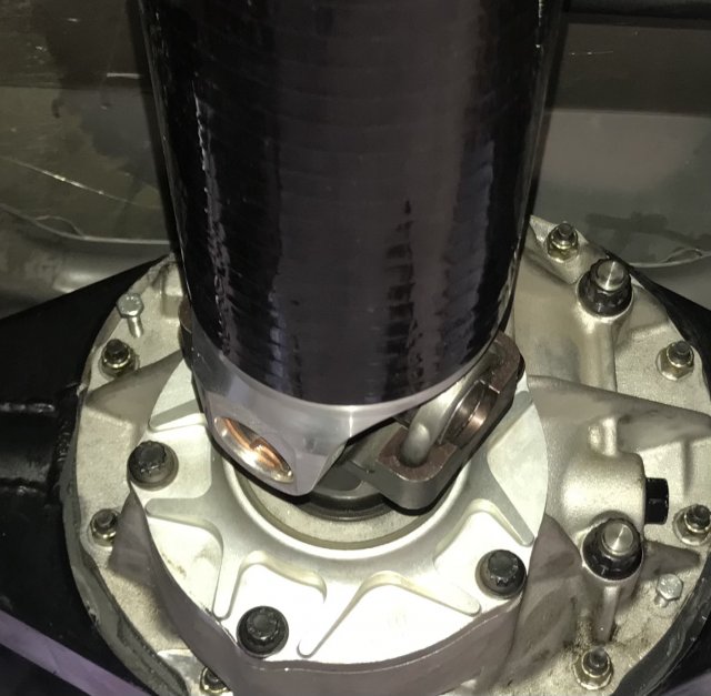

What’s a front diff brace? Is it an extra piece for the diff? (The only diff on the car.)
My buddy has an E85 M6 ‘Cat and he broke an axle the first time he had traction. Fewer than 10 hits on the car. Breaking axles isn’t as common on the A8 cars because there isn’t as much shock, I don’t think. Especially when you consider how many stock axles are running 9s or 8s vs total M6 cars in the 9s. M6 cars with traction and a clutch should consider bringing a spare to the track.
It hooks across the front of the diff.
