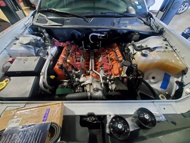

Update on the build: Car is in the shop having the maggie installed along with 1700id injectors, Big Jon Racing Idler kit, Fore Triple Pump, Gearhead Fabrications 108mm TB, Forced Induction Interchiller, light weight frt bumper support and will be tuned for Ignite E90

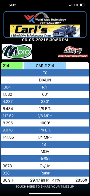

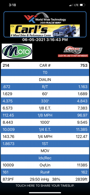

Made 4 passes this weekend on not so great track prep had to pedal it a little bit but did manage to set a PB. No issues with the VMP105mm TB, so will keep running it until we have problems. The FI interchiller was not cooling near as well as the last time out, so will check it for leaks and freon charge.
