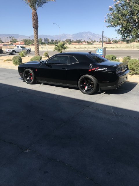

I’m running a 315 tire in the rear on a 11 inch replica with no issues on my Challenger! It looks badass with that staggered look.315/35/20 traction is awesome. View attachment 8917 View attachment 8918 View attachment 8919 View attachment 8920 View attachment 8921 View attachment 8922 View attachment 8923 View attachment 8924
Great pics, thanks for sharing. What brand of wheel is that, and do you happen to know the offset.
Primetime Hellcat 17

Who's rims you using and what offset? Those are exact replicas of my RE rims and would match perfect. Also those tires are Nitto's correct? @Blkout, as I have read elsewhere, said they run a little narrow so maybe that's why the success. BTW don't want to steal the thread but how's the King Kong cam doin'?
PK Auto Design makes them. They were a vendor on the other HC forum. There located in SoCal. I believe it is a 21 off set I’m not sure though.
Ya the tires are Nitto NTO5’s.
The next tire will be the Mickey Thompson ‘s 305/35/20 DR for abit better traction on the street with the new power level I’m at.
The Cam is awesome. I’m glad I did it. Thanks for asking. Also Blkout is correct. All 315’s tires are different in diameter. Call Paul at PK Auto Design he knows everything about the challenger and charger wheel and tire combo in running 315’s. There is always a 3mm spacer option available too.

Here is a few more pics with the 315’s on a 11 inch wheel.
