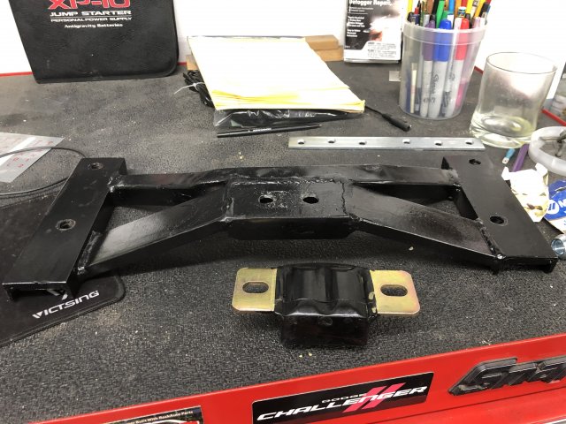

It attaches at the two mounting holes in the tail shaft housing using a stock GM mount.
Put the trans in and didn't like the rpm being so high when I just wanted to take it on a cruise I have 3.70 rare gears so I added a gear vendors OD
witch made my driveline a lot shorter so when I put my driveline loop in I used the stock carrier brg location
only gave me about 3/4 of a inch clearance didn't want to take a chance with the carbon fibre driveline

I have the OST plate and side to side movement was 3/4 of a inch each direction couldn't take a chance the way this is setup there is no movement in trans and gearvendor unit much more solid
Driveshaft is 54 inches

Here are some better pictures
It’s made out of channel and 1x1 square tubing
It mounts to the two holes To the rear in tail housing behind the adapter plate

Mount on trans
