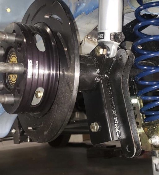

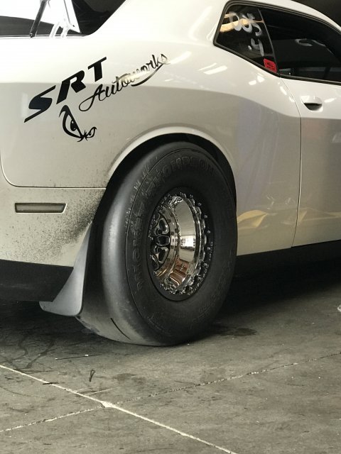

The new stance. 😬 BE8B2F18-49F8-43E3-9561-08802B89632C.jpeg 61F66F88-9DD4-4AC0-A3C5-BA46743C0B80.jpeg

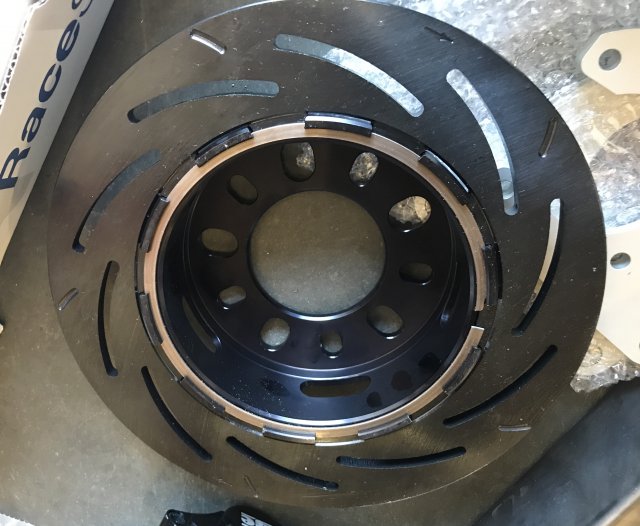

The light weight race brakes are super light. The Strange set I have on the rear are a two piece rotor design. Very trick! That’s so you can just replace the rotor disc when you wear them out every race. The disc is held in place with a big circlip. They are like ‘use once and replace’. No doubt they work if your car is 3500 lbs and you are willing to replace them on a regular basis just the cost of racing. 3572C801-8279-45FF-B9B6-81AA84658B57.jpeg B3B6EF1B-9EE8-4D4A-AC21-14467C23AECF.jpeg 3033DD49-4192-4B84-B3AB-C8D9A1BEF65E.jpeg

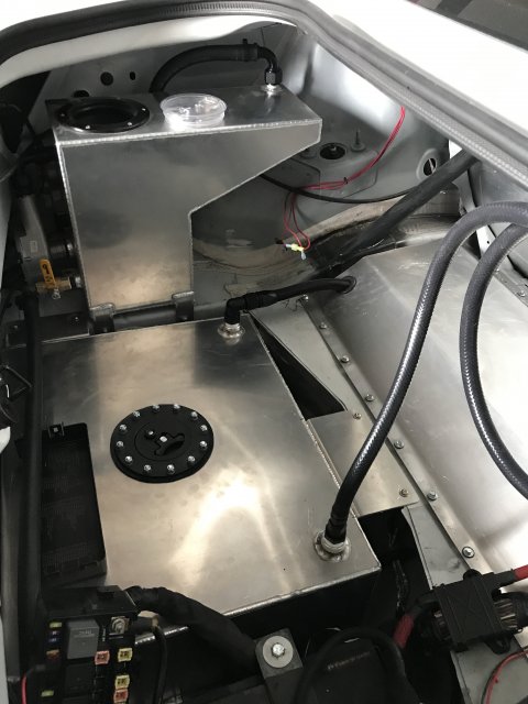

That drag pack is a real trick setup . How many gallons is the fuel cell ?
Nice . Stock is 17 gallon . So you can still go to 7 eleven to get your big gulp and make it home

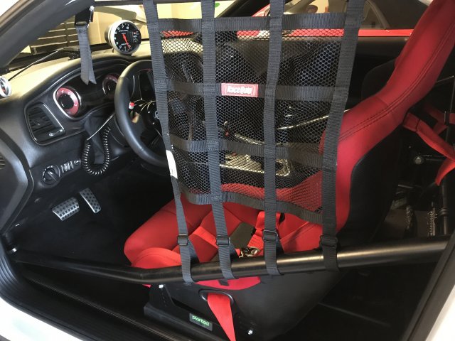

Something new! Stinky is warm in my garage and getting detailed. So time for some update stuff that got done..... checkout my new door bars. D09A7CE5-2126-4D0B-9F4C-9C6C34B2A82A.jpeg
