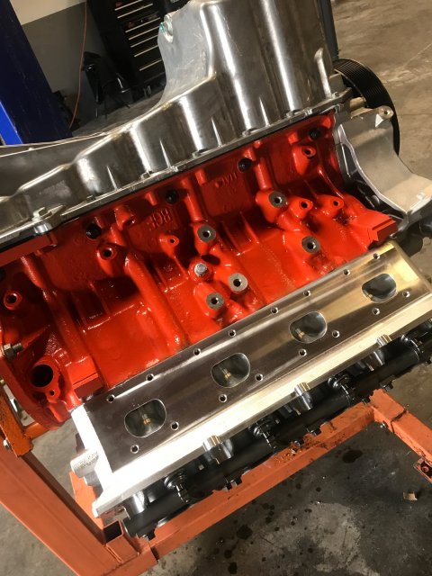

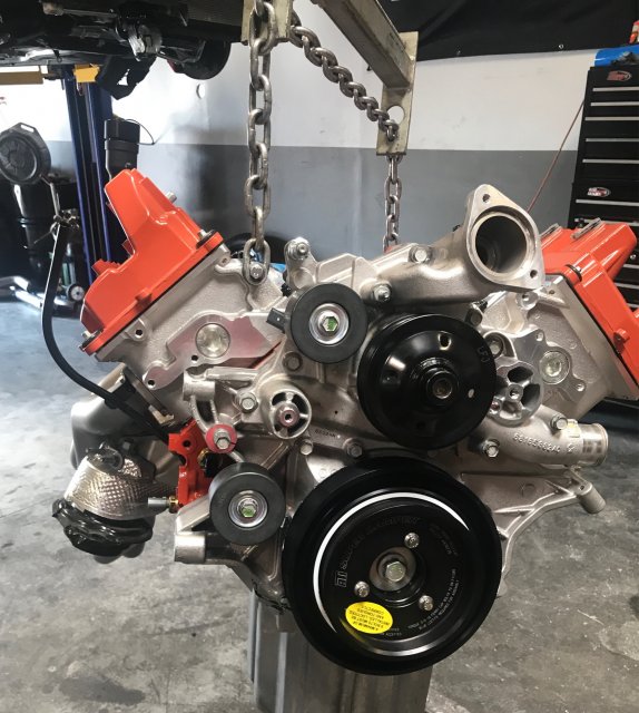

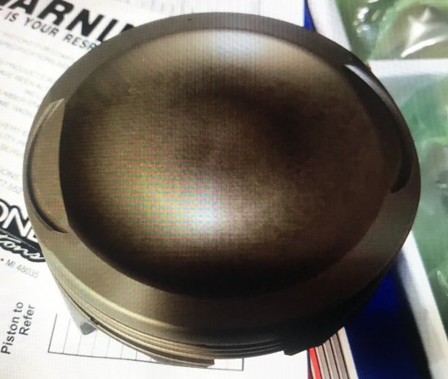

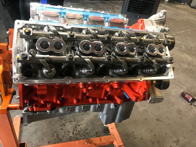

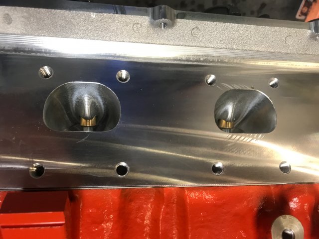

How to make 1500 hp without nitrous 🤓 7C1DB61D-0F65-437C-9C91-49BBC58C2CD7.jpeg EEC0A668-B953-406E-8965-B1BB8605AC83.jpeg 94AD98EB-33A4-4858-85BA-D963425D1D77.jpeg A09DE8C8-75CA-40C9-A5D2-0B377901510B.jpeg 4EC7ADB0-36EB-4544-AB5E-0AE4D683EFAD.jpeg 5794409C-5D27-43DF-AB55-C2E382403CDC.jpeg 008EDFB0-217D-457B-851B-6FC8C5257F85.jpeg 9D4C84B2-E407-4849-A962-0D8ECB8CDE96.jpeg 32464206-780B-4CEF-A197-820BD573AF23.jpeg 68869EF3-6FE4-4D67-8673-D05CC5AF4FD6.jpeg FC1D0A95-C55A-443E-83D0-97281CFAF7F9.jpeg
Very nice pieces . I do like those thitek heads . Maybe a future upgrade to bump me from my current 708 Hp to 709 Hp!
3,632
11,718
Thread Starter #764
I can guarantee that 1hp in writing! 😂

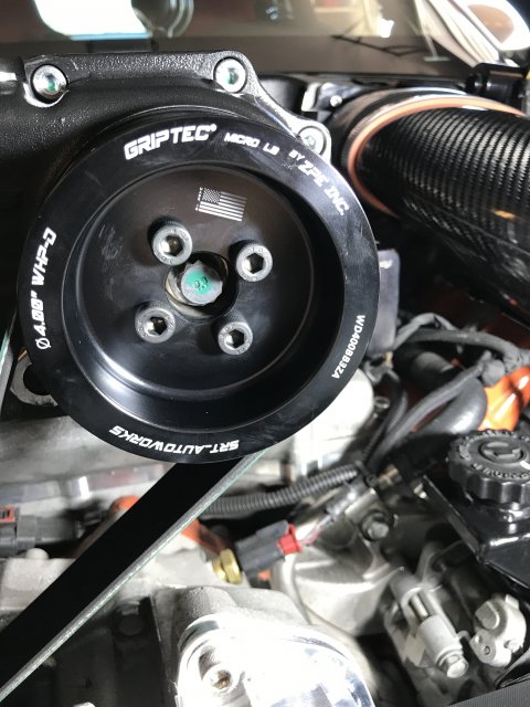

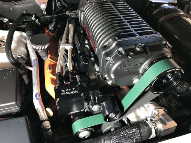

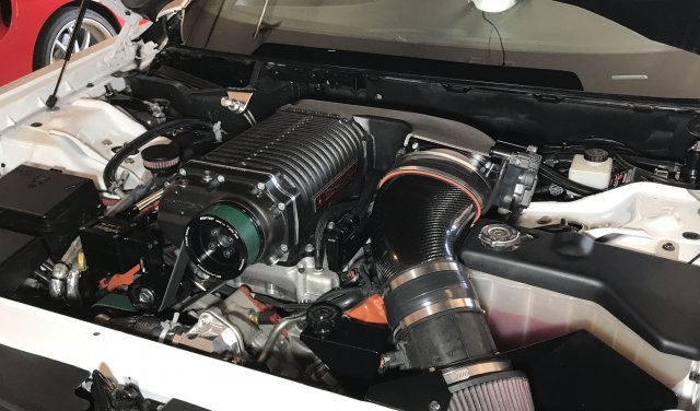

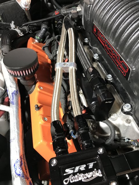

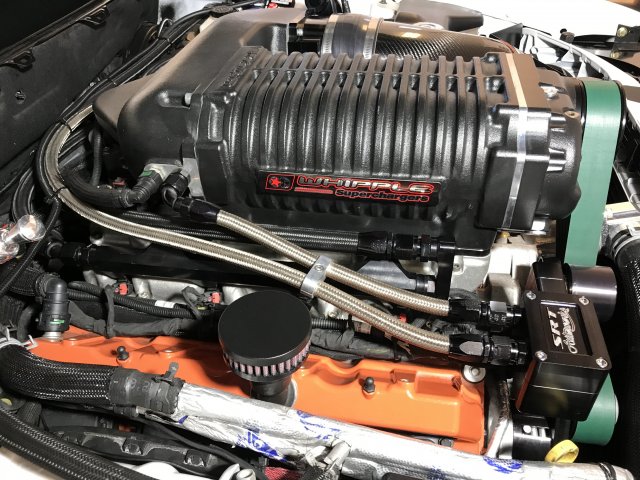

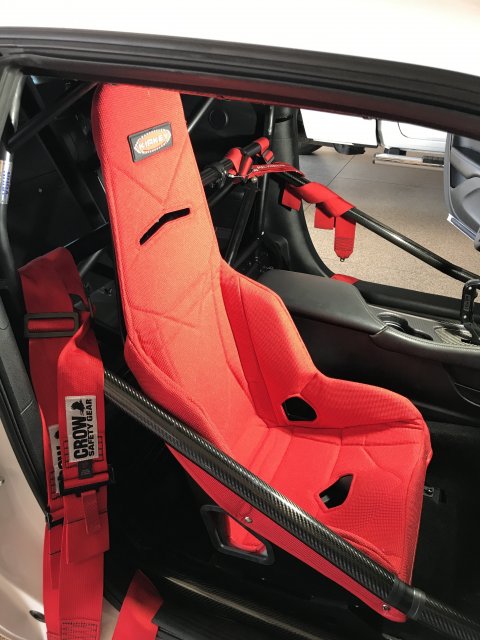

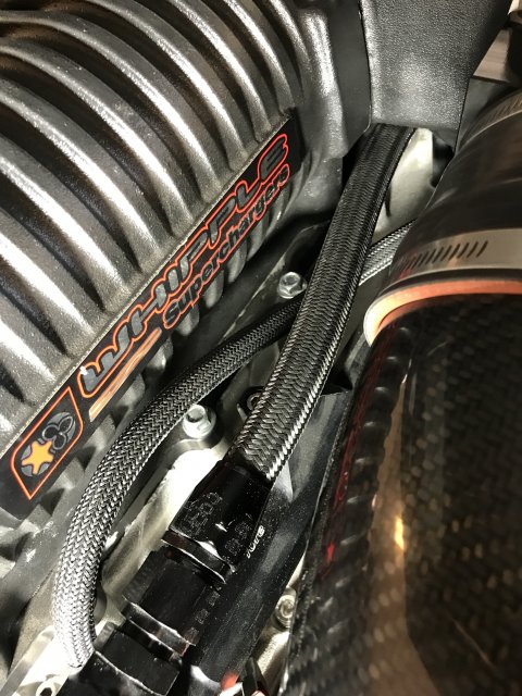

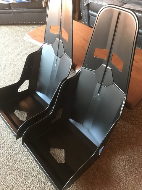

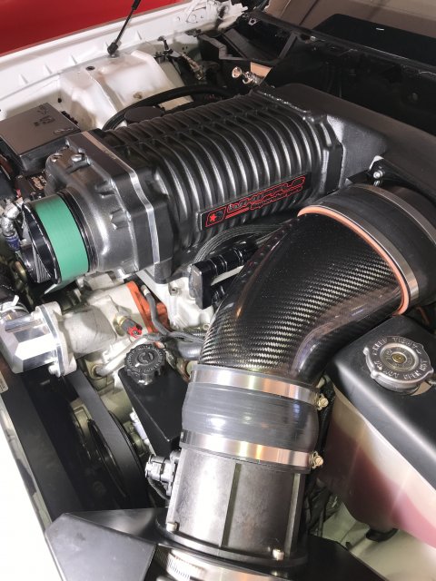

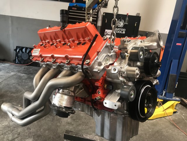

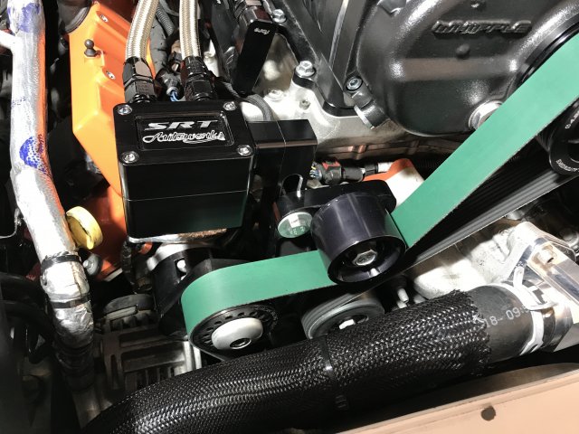

The old (heavy) ones are sold and the light weights are ready to go in. Weighing in at 15 lbs with cover and brackets I will drop 50 lbs over running the others. The new 3.0 Whipple DragPak race supercharger has been purchased and the Holley Dominator based EFI system is being put together. By fall the HellPak conversion will be complete. We will have some interesting pictures coming soon. 😎 3752F685-F880-4277-8C60-9750DC1A00B5.jpeg 8A7090E5-60DD-4A0A-AC5F-592015E7861F.jpeg 8EF529C2-F6F6-4AE9-8519-0B65AD93D9E2.jpeg

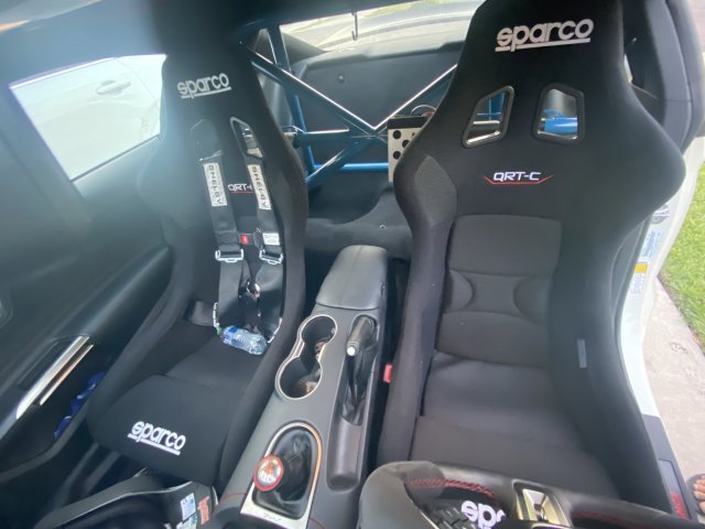

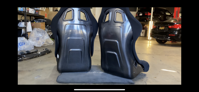

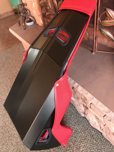

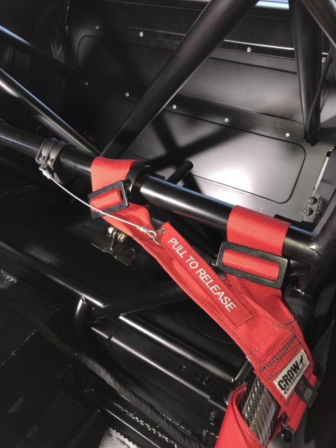

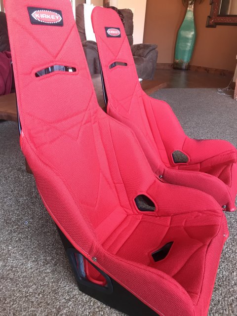

As nice as those Braums were, unless I removed the passenger seat for the track, I was lugging that additional weight (40 lbs). Once I went to the welded in door bars (preparation for the 7.5 cert cage) moving that seat in and out was a chore. I want to always have two seats in the car. This way I can do that without the performance penalty of the additional weight.

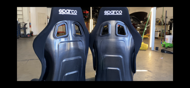

Looks like you need a gear vendors overdrive and carbon fiber driveline can make you a good deal
Cross country road trip seats!
3,632
11,718
Thread Starter #773
That they are not! Very tight fitting and actually comfortable to sit in as long as you don’t need to adjust position. There’s no adjusting 😂. My car only has a cross country range of about 50 miles now so I’ll be ok.
That they are not! Very tight fitting and actually comfortable to sit in as long as you don’t need to adjust position. There’s no adjusting . My car only has a cross country range of about 50 miles now so I’ll be ok.
Yes I have a saying around my house . " function over fashion" for the task at hand . How much do the covers on the seats weigh??

Those are some nice seats.

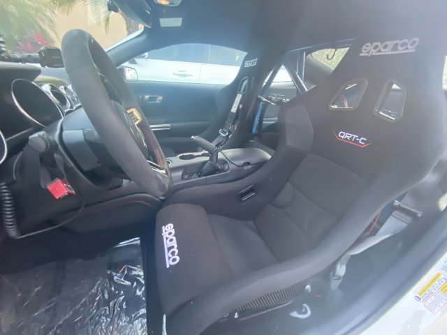

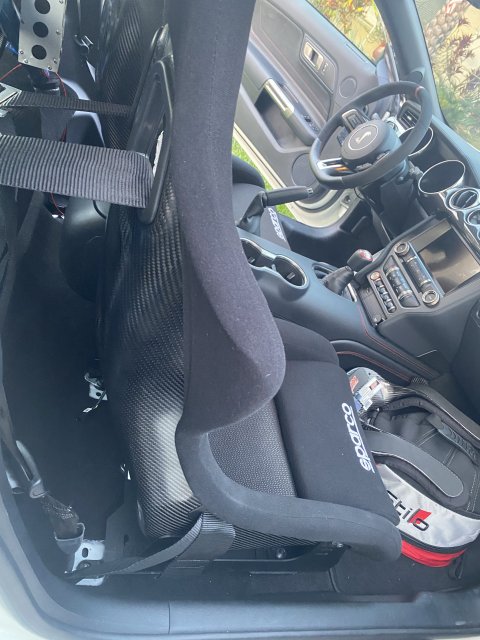

I just got these for my gt350r, 12.5 lbs each with the cloth.
25lbs combined vs 70lbs combined for stock seats.
Seat with cover is 13 lbs. The brackets are 2. So... 15 lbs. each. Heavier than WhipCat’s. Damn that carbon fiber. 😂

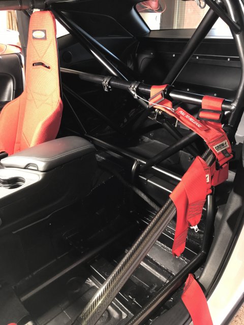

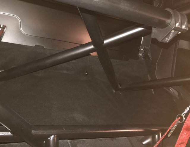

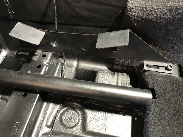

Got the aluminum rear firewall powder coated and the floor back there carpeted. Stinkeye version of the elusive seat delete 😬 830F9341-54DC-4D97-8FA8-D5D994CE4FCD.jpeg 7C61011F-3534-48BF-8F3E-E6B97BD8DF39.jpeg

WOW!!! Those cost more than mine. 😂. NICE!
Not to bad actually, $1250 a seat
The recaro podiums I saw were $3800 each!
