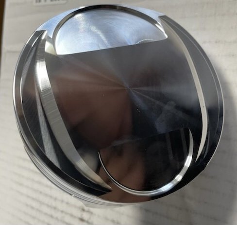

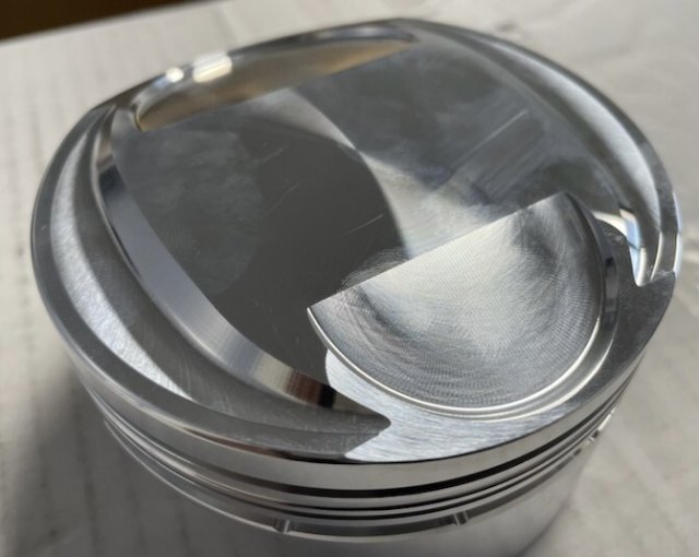

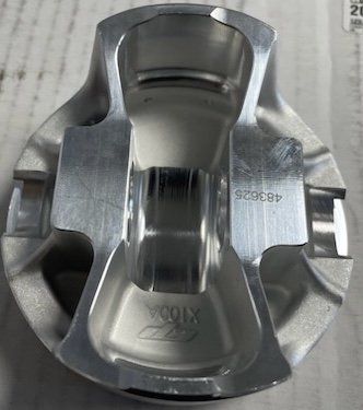

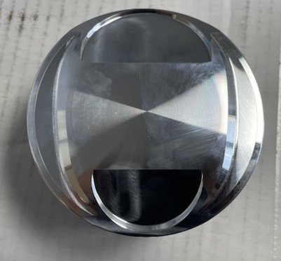

After 4 months….. FINALLY 😯 36FCEF1D-48B7-4CE0-86AE-F3F766A75F66.jpeg 3832E5C2-C4B5-407E-B818-C44F82272184.jpeg D9AEF933-6108-49D6-BC34-EC313288C171.jpeg 9556038F-1787-4EBA-8DC7-660B3FD11A14.jpeg

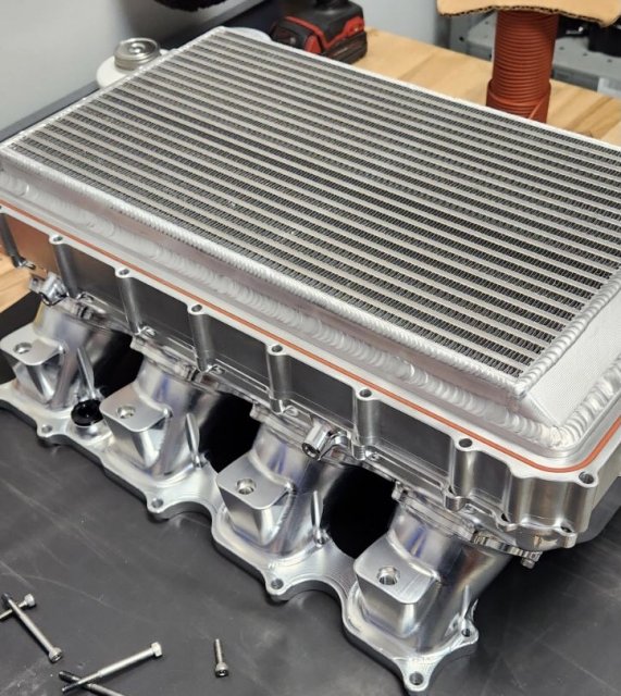

Thread Starter #1,363

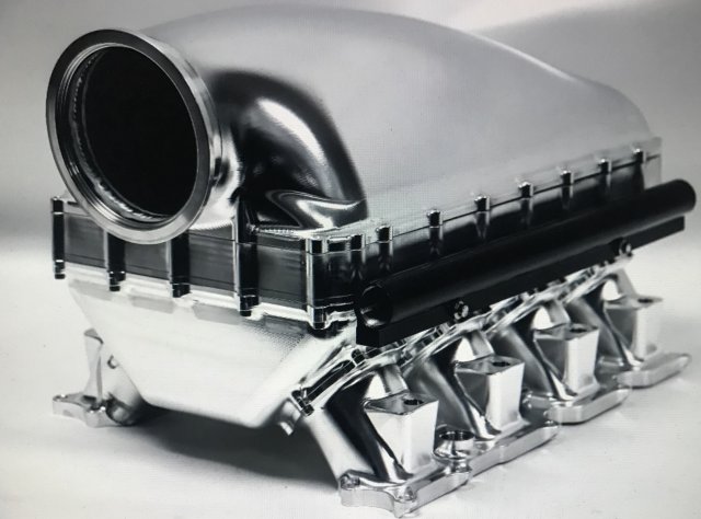

Big day today. The block is off to the machine shop for final work and then the assembly can start. A huge decision was made on the turbo build front. I’ve decided not to go with the air/air intercooler and instead pulled the trigger on a billet intake with built in air/water cooler instead. So I’ll be sticking with the icebox after all. On the plus side…. The intake tubing will be much nicer, running from the turbos on each side into a beautifully crafted Motion Raceworks CNC Billet Y and throttle body. Dual BOV’s instead of the single like Jim’s setup. A really trick feature with this intake and one of the primary reasons to go with this is the dual injector feature. To start I’ll just be using the 2200’s I have now but as fuel flow requirements go up, I can add another injector per cylinder. The next step up for me would be the new ID2600’s at something like $3k a pop. The bigger atomizers necessary for methanol are something like $5k. With this dual setup I can pair much less expensive injectors to get exactly what I need going forward without the high costs of the big ones. 😎 E149ADB9-A4BC-487C-89A3-A4C29900319B.jpeg

...Sounds like she'll be a great Drag & Drive ride for the future :giggle:. No coatings for the pistons?
3,632
11,718
Thread Starter #1,365
. Nope. No snake oil on the pistons. 😁

Man.
Big day today. The block is off to the machine shop for final work and then the assembly can start. A huge decision was made on the turbo build front. I’ve decided not to go with the air/air intercooler and instead pulled the trigger on a billet intake with built in air/water cooler instead. So I’ll be sticking with the icebox after all. On the plus side…. The intake tubing will be much nicer, running from the turbos on each side into a beautifully crafted Motion Raceworks CNC Billet Y and throttle body. Dual BOV’s instead of the single like Jim’s setup. A really trick feature with this intake and one of the primary reasons to go with this is the dual injector feature. To start I’ll just be using the 2150’s I have now but as fuel flow requirements go up, I can add another injector per cylinder. The next step up for me would be the new ID2600’s at something like $3k a pop. The bigger atomizers necessary for methanol are something like $5k. With this dual setup I can pair much less expensive injectors to get exactly what I need going forward without the high costs of the big ones. 😎 View attachment 117202
Man. One day. This is going to be a build for the ages

The pistons look good. It's unfortunate that 4 months isn't an unusual lead time for much of anything that's considered a custom internal engine component these days. I used to order Ti valves(pre covid) and get them in 3-4 wks. Now it's 4-6 months.
That billet manifold setup is impressive. I'd say you'll love the dual injector deal later on. I would think controlling the smaller holes will be much better than trying to make small changes to a huge injector.
It'll be fun watching your progression w this deal..

We’re looking at a 500hp power increase over what we’ve been doing so who knows what injector we’re going to need. I don’t think the 2200cc Bosch is going to do it. 🙄 Going to a ID2600 is an expensive jump and the bigger they get, the more of a challenge they are to manage. So now we’ll have a option to that. This dual injector thing is new to us but going with a combination of two smaller injectors sounds like a good idea from a fuel management point. And…. I like my green button 🤓

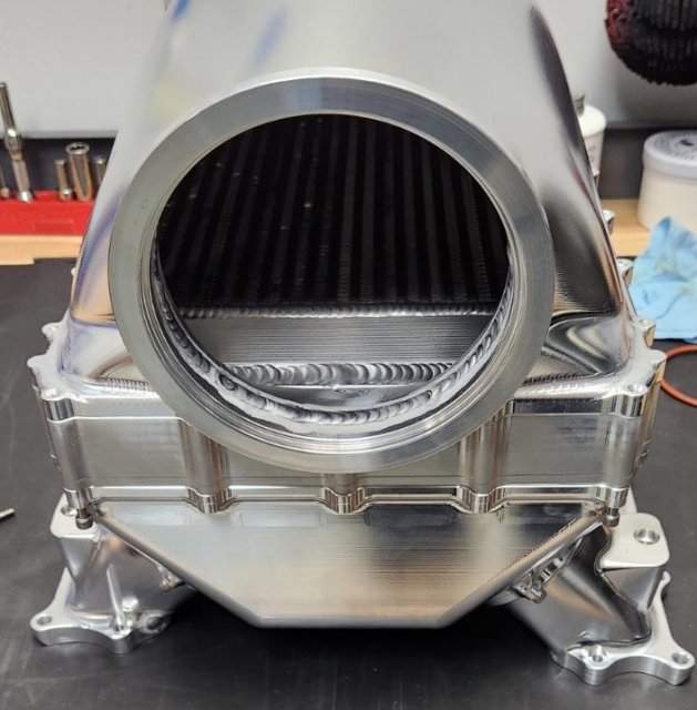

Huge Intercooler in this thing. 3.5” thick 😬. 27E9BE78-F3C6-4957-862B-A6E210D0677B.jpeg 2618CA5D-DDC9-464B-9F91-746C451D1B7F.jpeg F90312E6-3FD9-4707-A57C-8828E5ED5301.jpeg

Please tell me the runners have o rings where they meet the heads
3,632
11,718
Thread Starter #1,372
I assume they do as this stuff is made for Pro Mod boost levels. I don’t have it in hand yet so I haven’t seen what’s going on there.

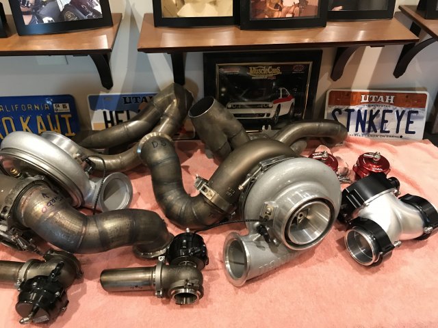

Some turbo bling came in today 🤗. I was going to start putting this stuff in a box but it looks too good on my office table. 674C0398-FE84-48F5-A1FB-A4E735A15A83.jpeg B295169C-1A92-47FE-8E2C-930BEC03266D.jpeg

You should take measurements or have someone do measurements of the turbo headers before you install em looks like an awesome design

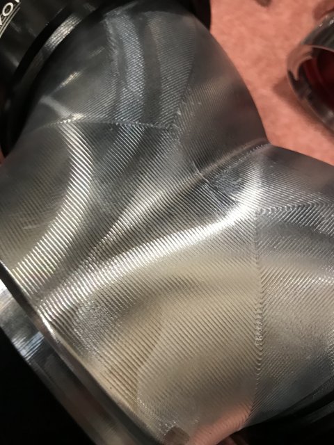

Thread Starter #1,379

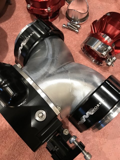

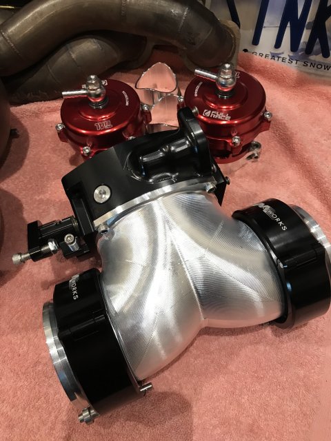

Oh wow that’s billet cnc, the Y? Beautiful

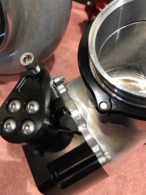

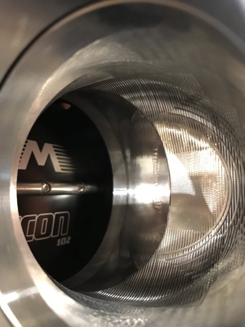

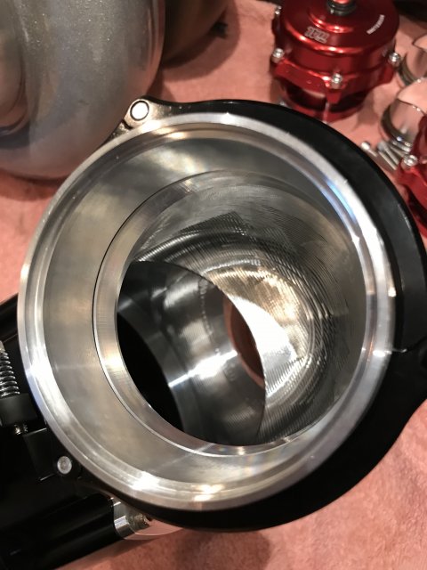

Motion Raceworks. They make bitchin stuff 😵‍💫. 11DF4655-91AF-421B-B25C-DCC0C3CA6A19.jpeg 4B2F436E-4735-4ACE-93DC-BA15E1768F47.jpeg B2621674-2925-4F52-8AA2-592D8DFE524F.jpeg DD94EFF5-5A45-4147-A78F-6FBB8287C254.jpeg 3BED0691-09C0-47BD-BAA0-7F7C57FD8A36.jpeg D14834A2-E60A-44BF-A7BD-2852C353B6CD.jpeg
