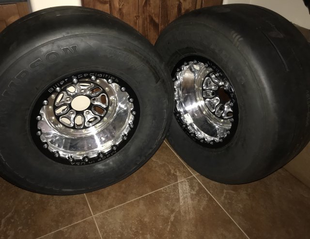

Fresh set of mounts ready for In-N-Out Fest. Mounted them up in my office yesterday and torqued the beadlocks this morning. These things are like a big Double Double. 🤤 635FF236-3C38-453B-A35B-9933BED54010.jpeg

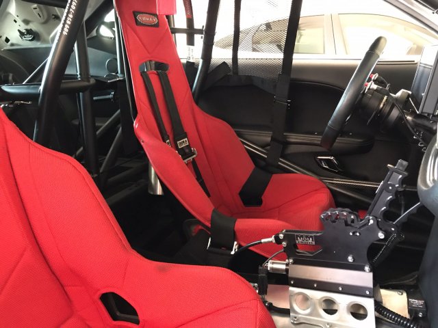

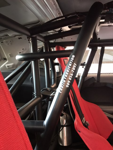

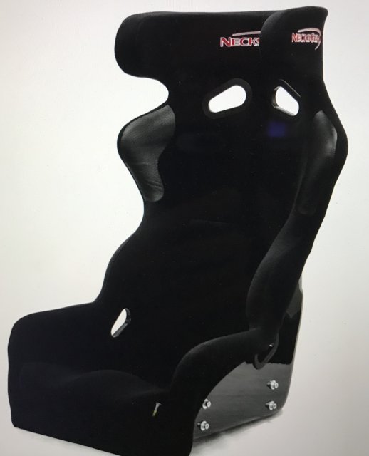

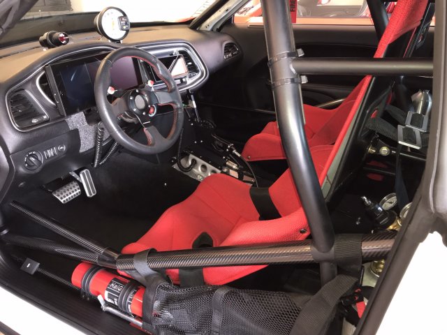

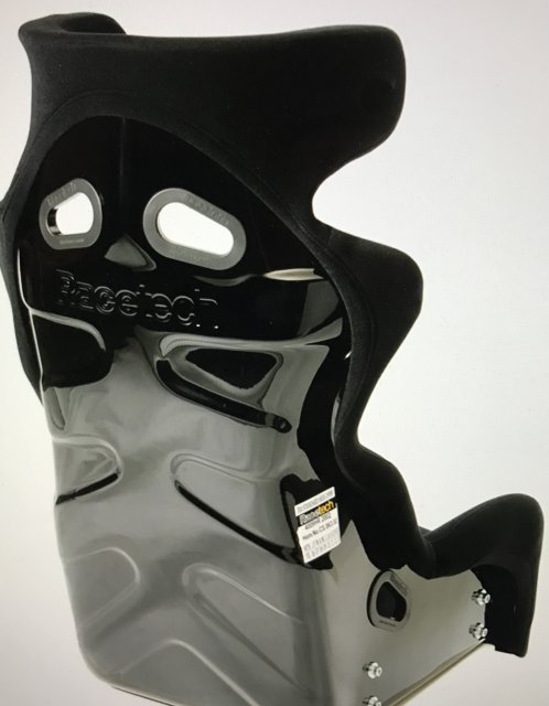

The money vacuum continues 😳. With speed comes risk and as much as I love my bright red Kirkey’s….. they gotta go. Once the 7.5 cert cage got the hoop, it added another concern. In order to leave room to get out of the car, the bar is right beside my head. It’s padded and I’ve got the best helmet money can buy but…. It’s a bar. I just purchased a new seat that will address that. If anybody is interested…. The Kirkey’s will be for sale in the future. 8F16A749-C7D6-400C-8FF0-03850D96ECE1.jpeg E72829B8-0211-49C5-AAB9-0B221CDB30F0.jpeg 7D8A4352-8F3B-4D25-A788-7107874395C2.jpeg E9BC8A5B-01A7-4843-BA53-726AED979D6F.jpeg 0E764C37-8474-49A2-BE30-8E849799FAB5.jpeg

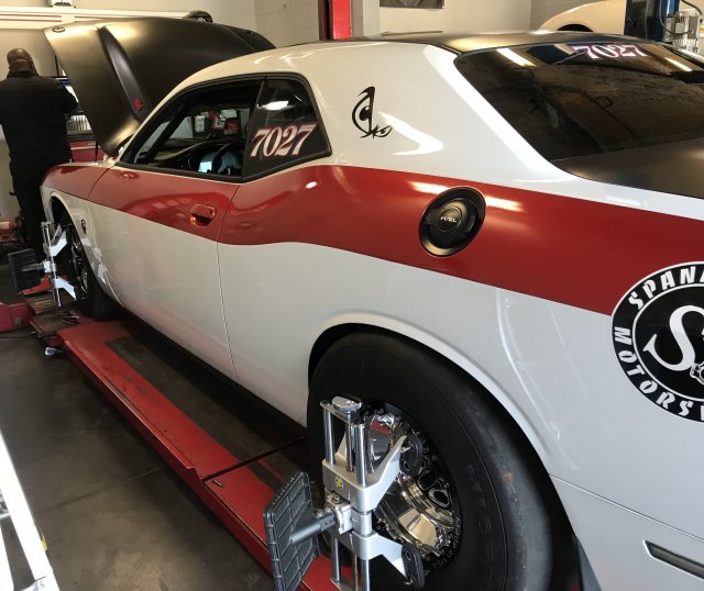

Car’s loaded and ready for In-N-Out Fest next weekend. One stop at the tire shop to balance the new Radial Pros and dial in the front alignment. Stinky is ready to kick some west coast ass. And enjoy a tasty Double Double after 🤤 3A54AC38-1B13-433A-9223-A27340E1CDF4.jpeg

At this point I’m making decisions based on the worst that could happen from a safety standpoint. If things go bad…. you’re going to want a bolstered seat that is as tight a fit as possible. Solidly mounted to the floor and roll cage in the back. No adjustability. Tight harnesses and neck protection in the form of a helmet tether device. The helmet should be as light as you can afford. I would suggest that you find access to the seat you’re considering and get into it to check fit. You’re not looking for long trip comfort that you can move around in. It’s a race car. I just purchased a drivers seat for side to side head protection from the roll cage that the Kirkey doesn’t provide. That’s the only reason I’m doing that. I found a close out deal on a Racetech manufactured seat that was last years model. The FIA certs are expiring so they are being rebranded as NecksGen and being sold at half price by them. They are a company that makes neck protection devices (nice ones). These seats are still being sold elsewhere for $1600+. I paid $900.
