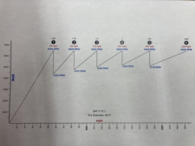

I was actually just curious to see the actual ratios of your old gears versus your new gears and be able to compare each of them. I of course know the stock M6 ratios.

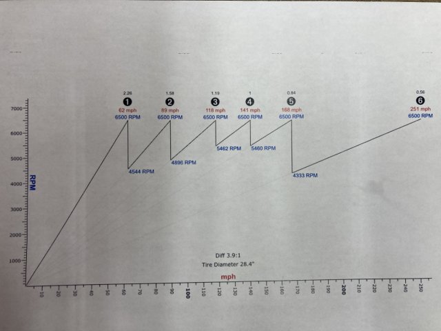

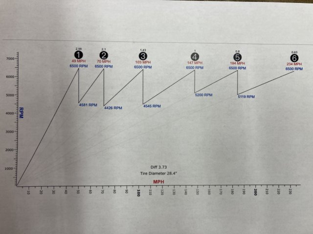

O, that’s easy. Here’s what I have now, what it was, and what stock with a 3.90 is
4D84A957-9835-4A79-8149-A3621A019947.jpeg 629B5953-8CA2-401E-B748-FE29F341F27C.jpeg DE6B268C-B1E7-4284-8CCF-A896F27E8336.jpeg

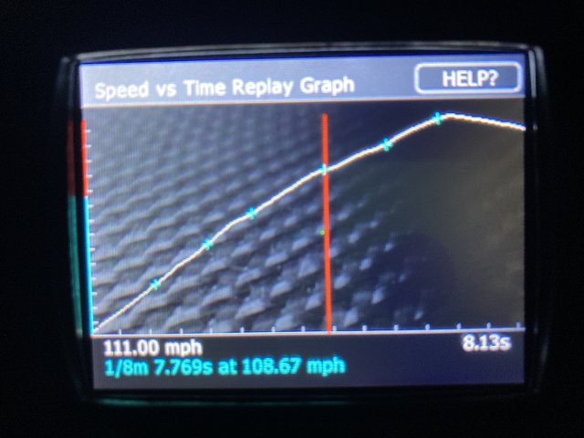

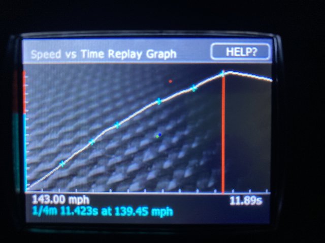

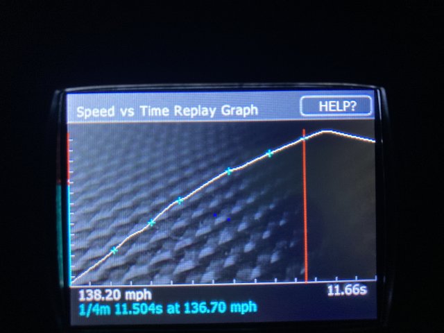

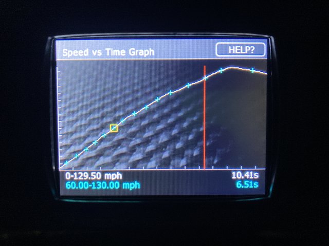

Just got home from visiting the bridge, DA about 0 here, car LOVES IT!! Liking this tranny more and more :)
Car timer getting it pretty close as well.

Picked up some new goodies to try. First is a 3.90 Diff, it’s going to rob from my 4th and 5th top end a bit but will give me the acceleration back in third that was lost from the 1.43 to 1.30 gear ratio difference and give quicker acceleration in fourth and fifth so I have to try it. Hopefully get this done before winter shuts testing down.

Be interesting if you even notice the difference from a 3.7 to 3.9. I don't notice the difference from a 2.62 to 3.09 which is a much bigger jump but also comparing stick to a auto
Yea, that’s a “I gots ta know” one for me as well lol
By looking at these graphs it will allow a faster spool up time, third will almost be what it was before and has to be an improvement in fourth and 5th for sure, I’ll be finding myself shifting into 6th on mile runs though, hope it can handle it. Heat because of extended time using it is the gear killer up top.
I have very accurate G force graphs of pull velocity so i don’t have to rely on seat of the pants feel. This data will be collected during 1/4 mile pulls so I’ll have mph by the foot by time in .001 second increments so Data will be the judge which one stays.
