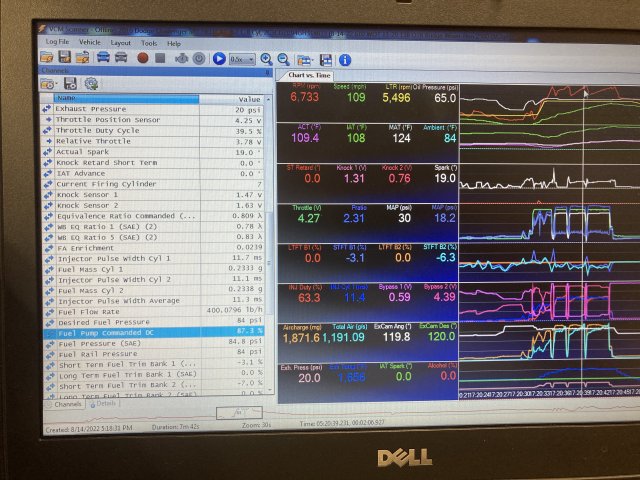

Inj DC there on the log as well in pictures, usually stays under 70%, I’ve got a bit of head room yet there. I’m running dual 285 pumps atm, have new inlet filters on the way, if they don’t get me head room back stepping up to dual 295’s will. This will keep me until I go Whipple someday.

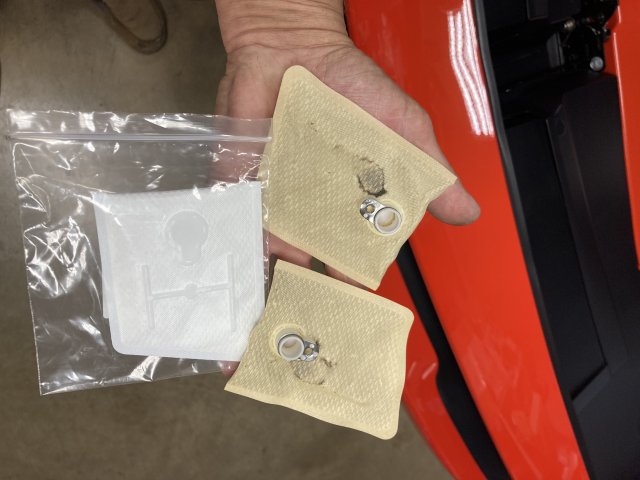

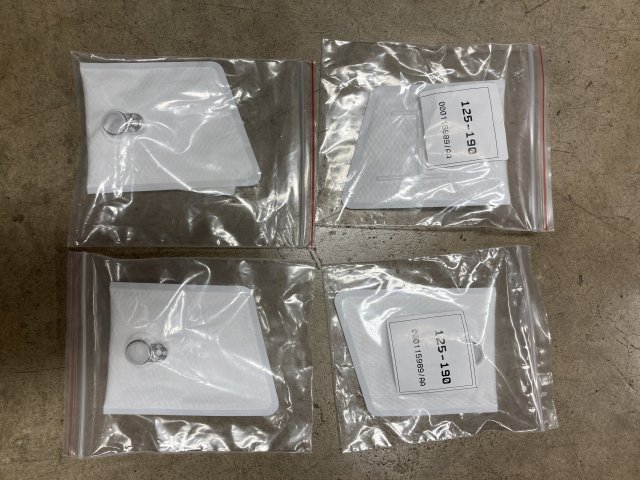

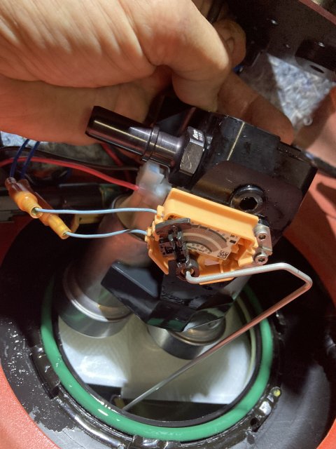

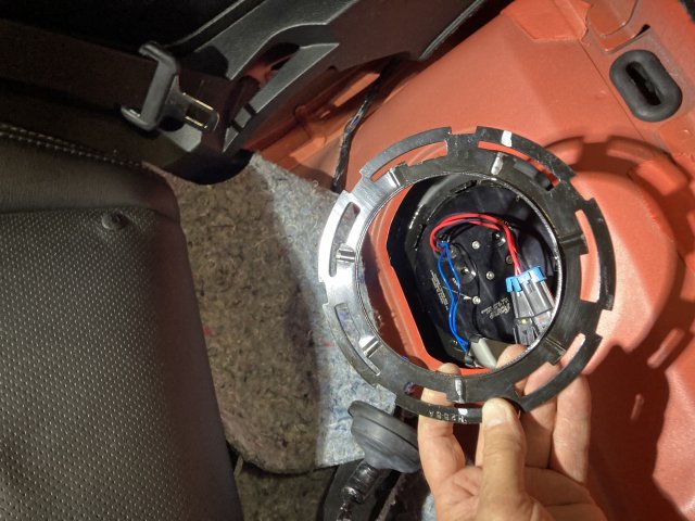

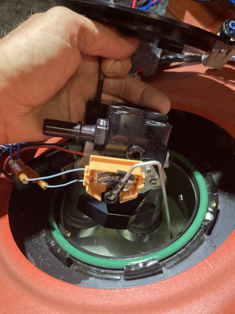

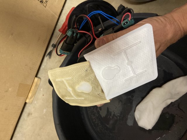

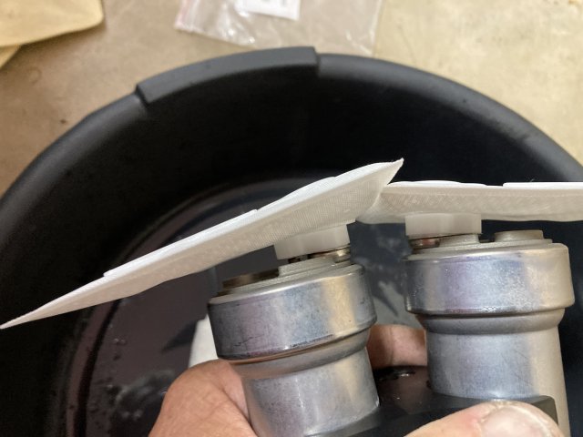

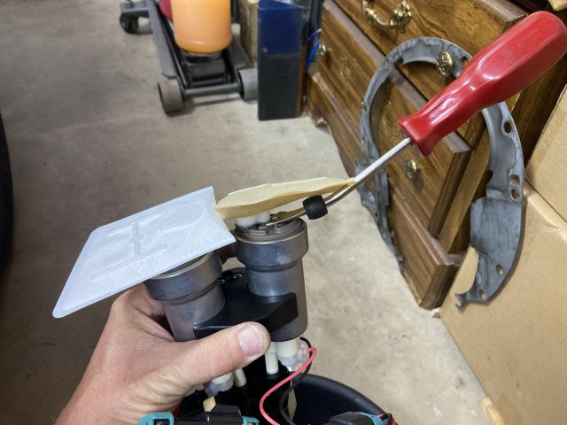

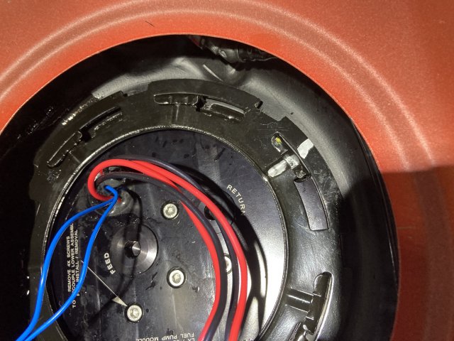

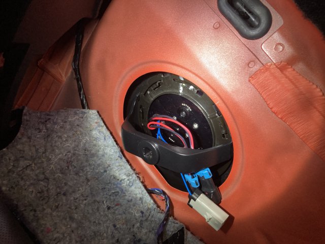

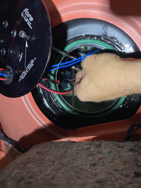

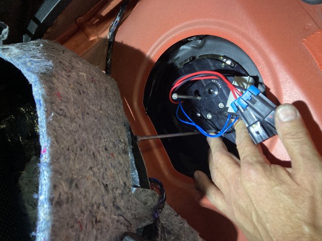

Changed pump inlet fuel filters, easy peasy 1/2 hr job.
Quick run down for those that never have done it
Get pumps out, a proper bung wrench makes it easy. simple as twist the lock ring off, disconnect the jet pump line, disconnect fuel feed line, remove float, take pump assembly out of tank.
874D9110-01F7-4F1C-800A-0450AE63869B.jpeg FE4D3196-5EF5-4D73-A4A6-0A81CE7472FA.jpeg D7A9F481-9DE9-4E2D-B9C2-99A0B8E7285D.jpeg 89722D5F-F296-43C6-B24B-34D017BC54D1.jpeg EE7F8E62-1518-4773-B73C-B1CD080F608D.jpeg 18ED9786-46B5-4269-AE1C-E72DF37F9A5C.jpeg A47D9507-7D9A-49B3-A31C-9DC0C1E874C6.jpeg 8F784AFA-F31B-4CFA-B32B-AE16A9173D49.jpeg
Use a push pin removal tool to pry old filters off, snap new ones on, put back in tank in reverse order.
3CA6F632-B978-46A7-9F4E-3E16800D1F1D.jpeg C2B7CD6D-9B27-4604-A1C4-C2C429F62C73.jpeg AC30D4CB-17E0-482A-BF14-1966640E1187.jpeg FD6E422F-539C-4EE7-8638-BCBC00A40E25.jpeg 8DFC2D49-BBCD-4F68-A0E8-D28BFD05DB21.jpeg C67DE559-1499-424F-9D1F-EBB082DE96BE.jpeg

What’s $15 and 1/2 hour of time net?
Fuel pump head room :)
ACC33651-DC59-4A9B-BF33-97BCE3156E4D.jpeg A27B9695-2D36-41F5-8B65-5F941A93093A.jpeg

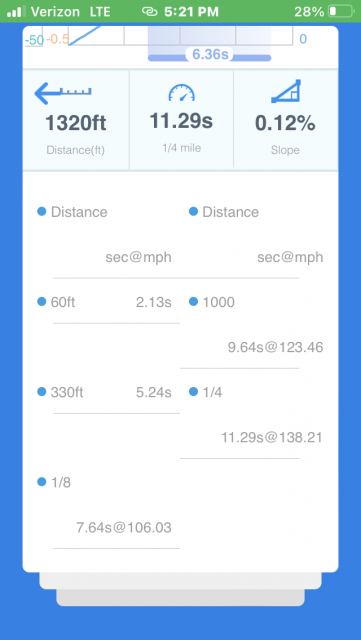

What that run net?
7E41FAE0-A90A-4CCB-B245-CCA43634F878.png EEED60FF-0052-47FD-86E5-D6A7B7190231.png
I need to get practicing launching again, this 60-130 running I’m forgetting how to launch this thing on the street. Sooooooo close to the 10.99 street goal

What did original filters look like.
3,828
9,073
Thread Starter #878
7,684
20,130
Not too bad.
3,828
9,073
Thread Starter #880
Their 30 micron, can’t see stuff that small but I guess there’s enough of it in there to make a difference. I have 2 new 295 pumps coming to see what that nets as well before hanging a third pump on there. I need a bit more head room to support a small dry shot of giggle gas for inlet air temp and blower cooling :)
