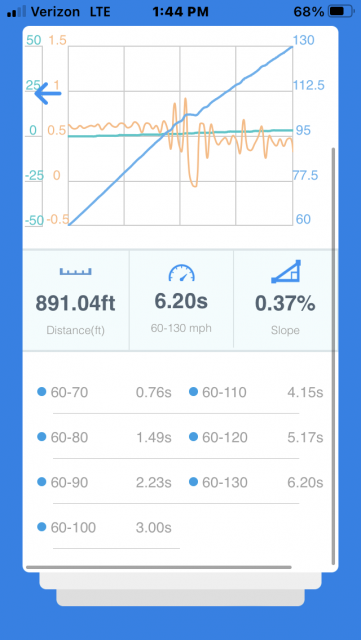

Excellent info from Brett and I agree with him 100%. 2.72 and +10 lower should be the extreme limit for a 2.4. I was originally running a 2.85 with the +10 lower until the 2.85 failed (moved back into the snout) and I had a 2.72 on hand so I used it. Was there a gain going to the 2.72? Slight, If I were to buy a new one I would probably buy a 285 being that these 272s aren’t lasting very long it’s just too much power transfer going through them.
This info is spot on HP wise, I’m making about 975 wheel with a 2.72 and +10 lower.

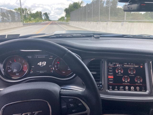

My savior is my killer chiller is still working great and keeps the IAT’s in check even in this 90F heat. The blower with the pulley combo would never survive long without it.
And she still performs well even in +3000 DA.
Notice the time on the HMI and the run time. These pictures taken right before and after the run.
The squiggly lines in the top of third just before the shift was the tires breaking loose at 100+, PURE FUN!!
Now if I could just get these pulleys to survive more than a month LOL
