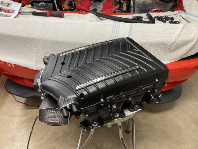

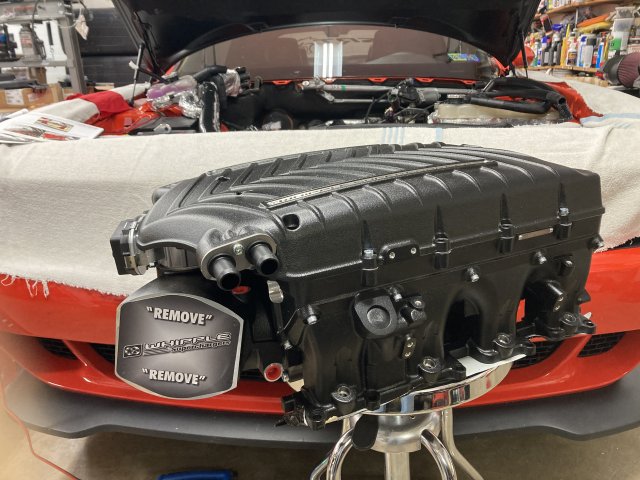

The Beast is out of the box!!

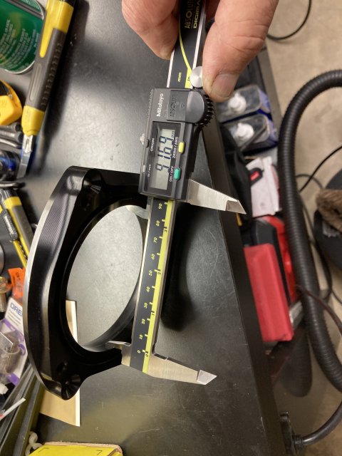

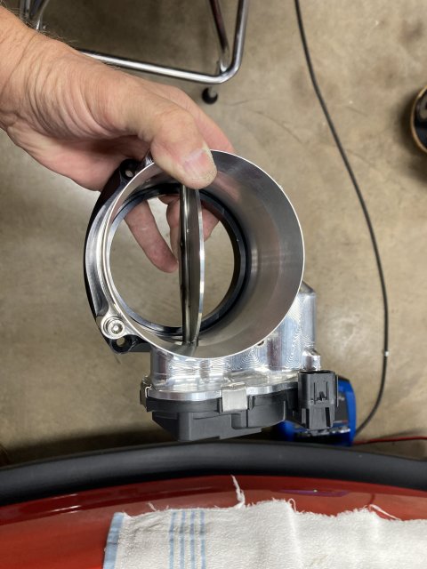

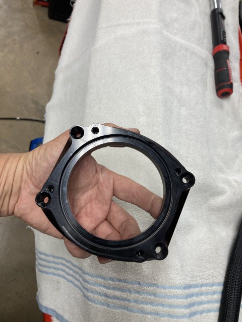

Problem 1, TB adapter is sized for stock TB, They say it’s ready for up to a 108 TB, I guess only if you have your own lathe LOL. Guess I know what I’ll be doing at work tomorrow morning lol
Taking it out to the outside of the factory Oring groove, which will open it up to 107.64 mm leaving hopefully the black anodizing in that area.

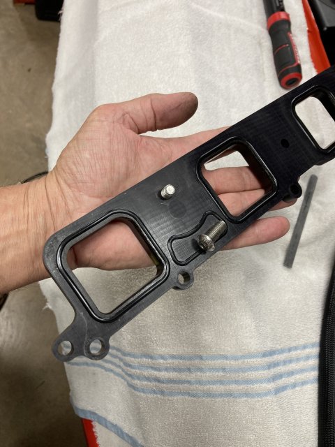

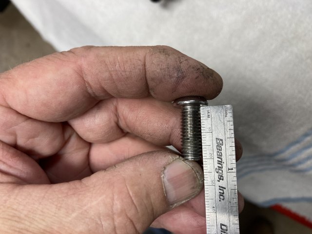

@Speedy!
Bolts to hold insulator Spacer plates in place, M8 x 20 mm long Stainless Steel Button Head cap screws

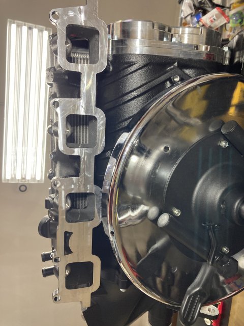

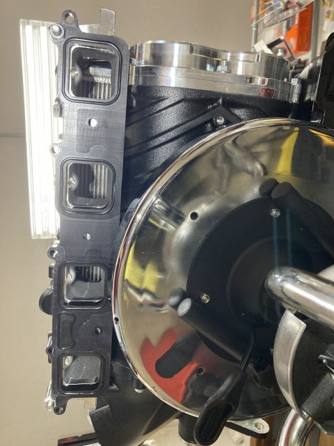

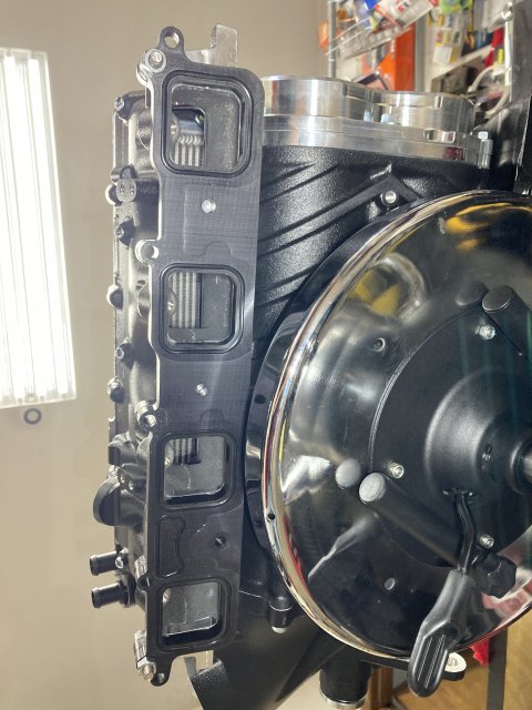

It was suggested to me to not use the Insulator plates but I don’t see how they could be a detriment? They are port matched to the cylinder heads and are a little larger in diameter than the ports coming out of the Whipple so that should help the transition not hit a sharp ledge edge on the head I would think. Opinions?

Thermal spacer and longer runner both for air and fuel charge, seems like pluses.
Only downside I can think of is physical spacing within the engine bay.

Another downside (but not different than the IHI) would be the timing of the injector pulse to the valve timing...

My vote is run 'em for their intended thermal benefits. The port sizing/geometry is in the proper direction, i.e., no "wall" for the incoming airflow to hit
View attachment 79841 View attachment 79842
Saw some were boring out the adaptor. Are bolts missing off the lid?
Yes, I will be boring the adapter out tomorrow to 108 mm. They only put a few bolts in the lid, it has to come off to install something inside. I color scanned the instructions with the intent of posting them but the pdf is 75mb in size, can’t even email it :(.

No, these are original FI insulator plates but I can add spray bars to them, I can gun drill them end to end, someday. The bracket I will post pictures of where and how it goes, took me a bit to figure out how its intended mounting is.
I will locate the plates with dowels into the heads but not into the blower as there no holes for them nor screw holes to secure them to the bottom of the blower like is done on the IHI
