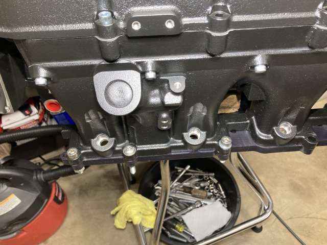

That bracket goes here, bracket bolts to the back of the water pump flange then the flange in the SC bolts to the other hole in the bracket.

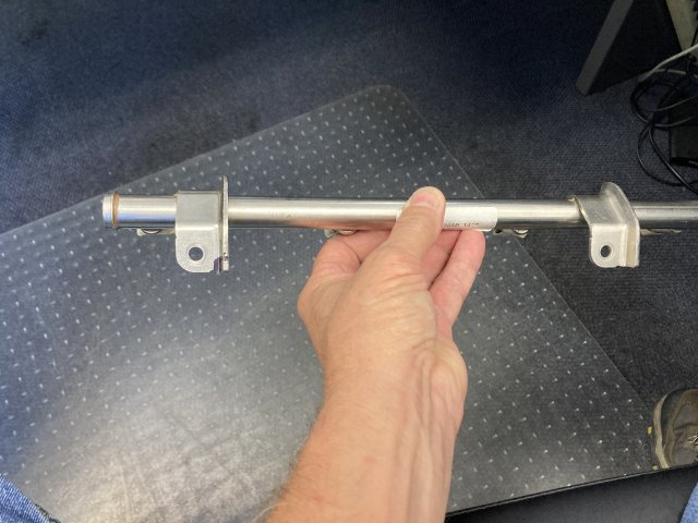

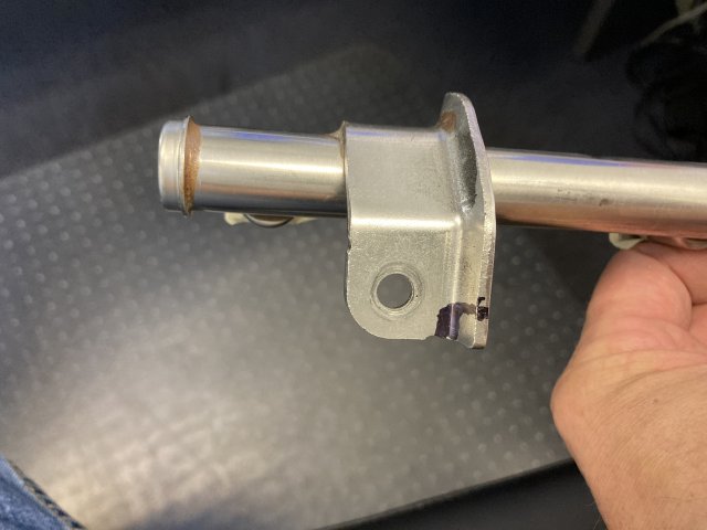

Here’s what needs cut out of the stock drivers side fuel rail mounting bracket, the instructions show this needing to be done as well.
