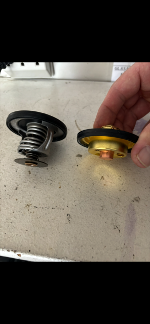

Buyer beware on those Jet thermostats, I’ve had a couple go out on me, they either start to open really late or not at all. I had read of other people having issues too with them on other chats. I’ve had one become separated inside the thermostat housing too, luckily the piece did not drop down into the water jackets surrounding the engine!
I had used them for years on my previous Hemis, don’t know if there was a design or manufacturing change? But they initially open at around 188 which is warm enough to not throw a code on the stock tune, versus the Milodon or Mishimoto that open around 177-179. Yeah I too would like to know which unit comes with the Direct Connection packages.
Stock unit versus the Milodon, Mishimoto is similar to stock design but I don’t have a picture of it.

Have you been able to verify if your thermostat is opening at 203 as it should? After the car is warmed up is run at a variety of conditions the coolant temperatures could go anywhere from 197/203 to up to like 217 when the low speed fan kicks on.
This time of year my car runs from 197 to 213 depending on street/highway and ripping on it, but it has been warm this week and I have hit 217 when the low speed fans turn on.
Stock thermostat is here:
https://www.eastcoastmoparts.com/oe...zcnQtaGVsbGNhdC1yZWRleWUmZT02LTJsLXY4LWdhcw==
Mishimoto:
https://highhorseperformance.com/mi...-thermostat-gasket-for-5-7-6-1-6-2-6-4l-hemi/
Milodon:
https://www.manciniracing.com/mihith1.html?gQT=2
https://www.jegs.com/i/Milodon/697/...ODT_XDdfksksQmfealWbZCuKsjpBjMlxoCajMQAvD_BwE
Good thing about the Jet 180 you ordered off of amazon is that it will come with an extra gasket. If you are keeping the car on the stock tune for a while longer I would just get another stock 203 unless you are comfortable running with a CEL light - I do it all summer like a bad ass outlaw! ;) I swap my thermostat every spring and fall, it's pretty easy when the motor is cold in the morning.
