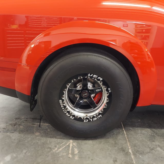

And these 315/60-15's are big. 20230103_170028.jpg

I bet it is a different car with those installed.
56 LBS.?

I don't know exactly what to expect from these tires Mike. I plan to run the car some this upcoming season and our local tracks aren't exactly known for being particularly sticky so this seems the way to go. On a killer track I'd say a good 17" might be quicker - solely from the weigh savings.
The 56lbs is the weight of that wheel/tire. For comparison my 17" Billet Specialties w the 28" Hoosier weighs 42 lbs.
1,637
13,909
Walland
21 Challenger Super Stock
Them’s some big ass tires ! Sure fill that wheel well nice.

They are big! They're pretty much all that'll go under the car.
