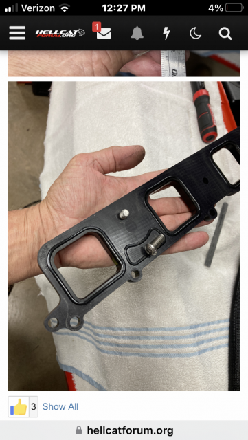

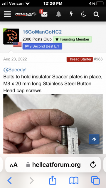

Bringing this back to life. Planning on re-assembly tomorrow. @16GoManGoHC2 you suggested I use SS button head bolts instead of the plastic push pins on the FI spacers? Do you remember size and thread pitch? I think that's the only thing I don't have sourced.
Mike confirmed these are M8x20mm figured I'd mention it for anyone following a long. I couldn't find them at the big box hw stores so I had to go to Ace. $1.60 each (!) and I needed 4.

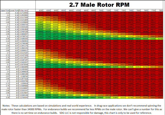

SDG blower speed chart for a 2.7 you are fine at 6500 2.85/10%

That's what the chart says.

2.7L Efficiency Chart from SDG for those interested. Of note is the text at the bottom which my attention was drawn to.
