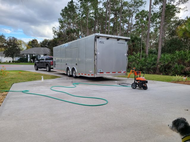

2000 lbs? Mine was rated for 10,800 lbs. It did a great job with this setup. I traded when I went with an enclosed trailer.
Sorry, but I don't care what the J2807 ratings are. A 1500 is still too light and has small brakes. I wouldn't want to tow that setup with a diesel crew cab 2500, at least not one with the idiotic 3.42 gears they used for years.
If that setup was great, you may want to try a 3500 with duals. But you already used "great" so it may become a matter of having run out of superlatives.

I have a 2500 now. It does an amazing job pulling the 28' enclosed trailer. This ain't my 1st rodeo.

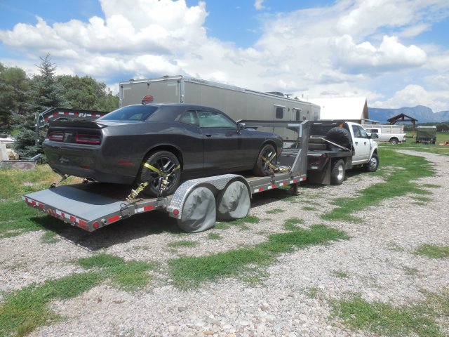

By now you know what my preference is. And not only do I have a significant tow vehicle advantage...there are fewer doors to drag around on the trailer. DSCN4478[1].JPG
Is it overkill to pull a single car with a 3500? Maybe. But I don't mind the extra safety margin one bit.
29,476
130,809
By now you know what my preference is. And not only do I have a significant tow vehicle advantage...there are fewer doors to drag around on the trailer. View attachment 77031
It depends on how you are going to use it. Mine is used for a daily driver and hauling the car and trailer. A dually would be a tough fit in my garage. It does a great job. The trailer is all aluminum for a significant weight savings.
5,502
10,541
In my case, the only thing the 3500 is used for is towing. Had a nice little aluminum gooseneck flatbed when all I had was a 2500, but the stuff I tow has kept getting heavier.
As you can imagine, the 38-foot (aluminum) toy hauler in the background is pretty much DRW only as it puts well over 4,000 lbs. on the coupler, as does the 32-foot flatbed behind it.
Sounds like you need a larger garage - and a nice 2-door for a daily driver.
