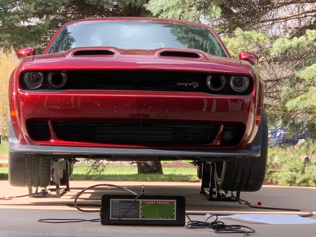

This alignment took adjustable four corners by AAD, plus the BMR rear toe adjustable items. It ran a 3.3 second 0-60 and 11 sec flat on the street with street tires. It don't flipping hop anymore either. It feels out of this world to drive now, big difference from stock.

That alignment was done with a set of 305/35's on the OEM 11" wheels. Jury is out on the 12" wide setup. I just mounted them up and will be shaking it out next Sat-Sun. I just did a drive and warmed them up, and checked the temps, I was surprised by higher temps on the inside of all four corners, even after I was throwing it around pretty good. I know 12" wide rears with some 345/30's work. The PS4S's returned some excellent acceleration times. Several attempts on that last drive this afternoon, I tried to get the Cup 2's to break loose at speeds above 30-40, those are also 345/30's on 12" wide wheels, it was biting down just fine. She is ready to lap. It should come out of the corners with the best of them.

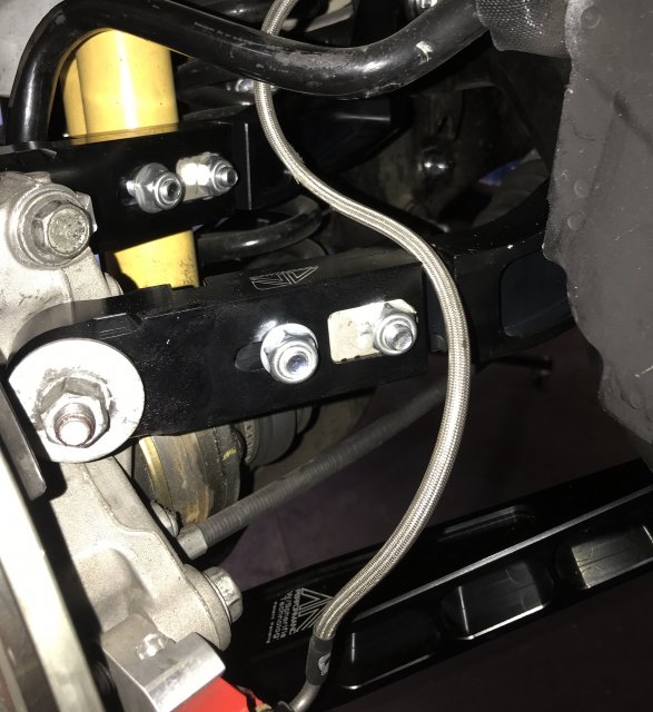

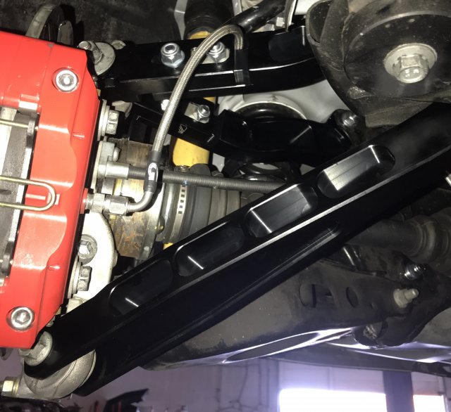

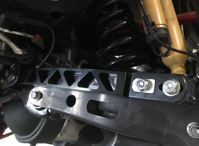

Full tilt rear IRS upgrade for the lapping crowd to help with our apparent handicap there. I have AAD on the top arms, I really like the BMR toe rod. I did NOT like the BMR tension rods yesterday. I replaced another set of arms I had on it. The spindle end of the BMR arm was about 1/8" more wide than the OEM bushing there. WTF BMR, new measurements, or did you not send me some necessary hardware? -uck it, I squeezed it down. If it looks like shit after a session, I will have spares with me and I'll be a bitch! I also have the Whiteline bushings and the big differential brace our brothers on the Forums have made for us. The DP rear two piece rotor is also installed for the viewing pleasure here. No hop any longer, I have even tried to get it to hop, it is really fun to drive with some large meats out back. The NVH on the street is NOT any greater with all the changes!
I also have the AAD adjustable arms up front with some other goodies to drive these 325/30's. Bolted on this set yesterday with the change in brakes to track it next weekend. Yes, I will wash the bugs off and give it a nice bath this week. Some alcohol presoak melts them off that wrap on the front bumper.
