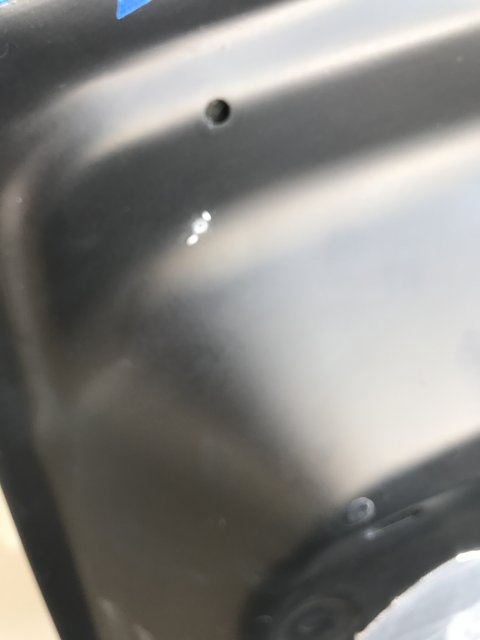

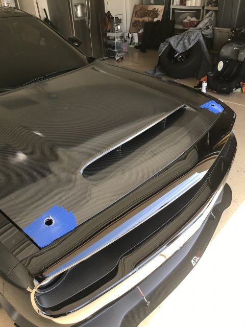

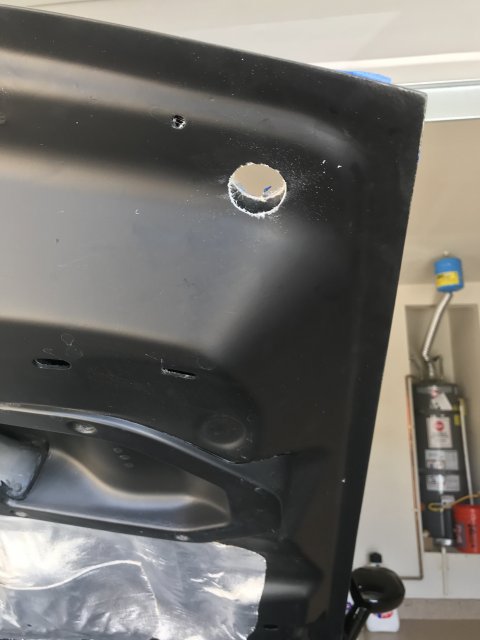

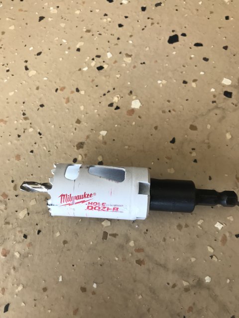

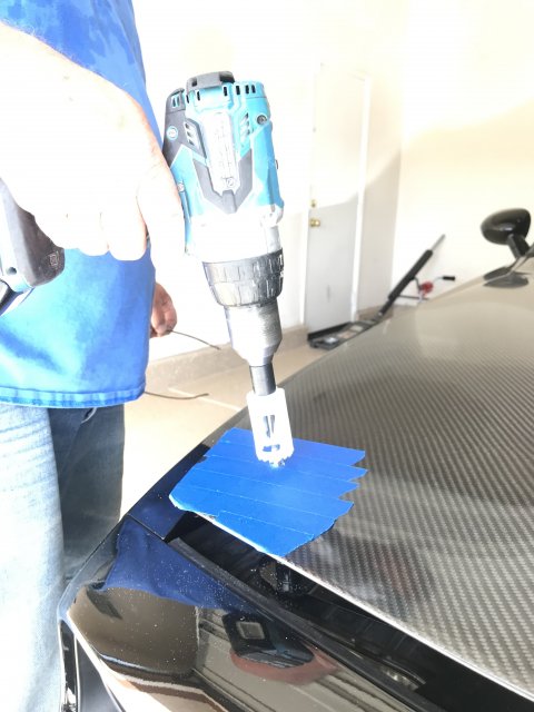

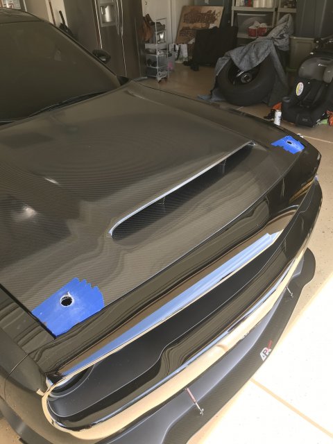

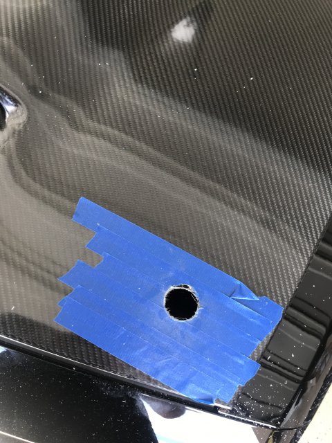

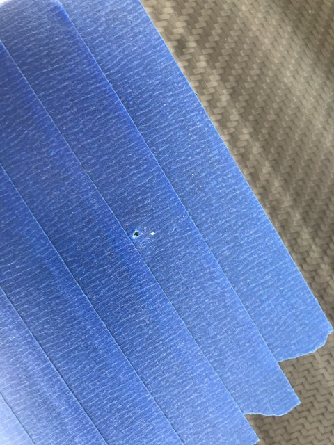

Well me and my pops did it our selves... Really was a easy job. Took about 30-45 minutes. Used some blue painters tape on top of the hood to prevent any cracking or chipping in the clear coat. Helps to prevent the spider Webb effect in the clear coat. 2B6ED622-1E62-403E-968F-671837BD54C3.jpeg 47E338DB-595C-4FDE-B483-C4962AD52C08.jpeg 42B01384-6D73-4152-8908-23CA419CFC53.jpeg E44A5151-D4FA-42B3-8AC9-AE31DE161AC3.jpeg 0DA60123-2F17-4CE4-8CDB-8EE40FFC8EC0.jpeg 1CCB7E14-372B-4B42-9268-2D1F4776C3CB.jpeg F4A7F75D-4AC6-4AB4-AF93-C5B74E6554AB.jpeg 9EC664A3-0FE3-462F-9956-7B76B71B0D6D.jpeg

Gonna finish the hood pins after I get the clear bra installed this week. I will post up pics when it’s all done.

Looks good Primetime!
