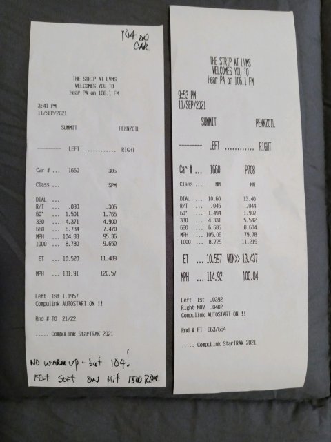

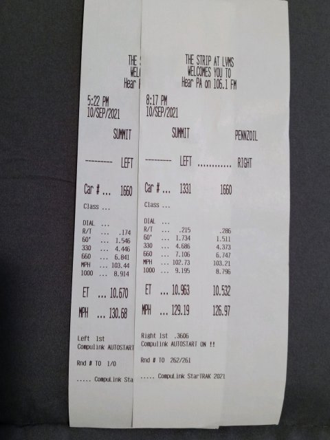

TIME SLIPS from the event. Both of Fridays and a few from Saturday. The last one from Sat I was on a pretty good pass based on the sixty and the 1/8th MPH and ET. But....... 0914211236.jpg 0914211235.jpg

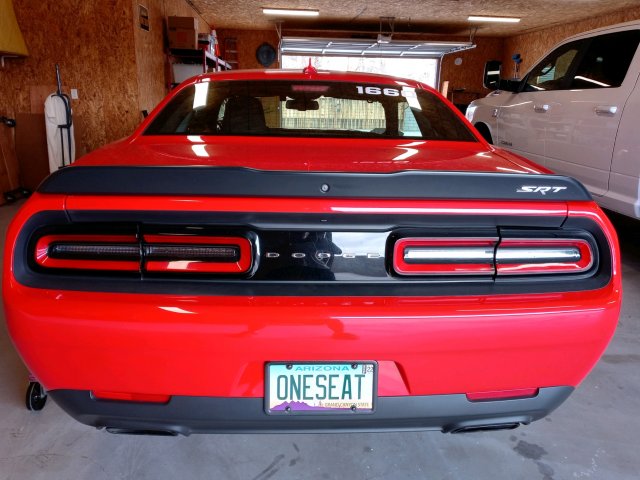

Went to the ADOT today. I got the enhanced Drivers license with Motorcycle endorsement, 1 year Registration, Title and personalized plates for the Demon. Here is my temporary tag for the car. 0926210837_HDR.jpg

TIME SLIPS from the event. Both of Fridays and a few from Saturday. The last one from Sat I was on a pretty good pass based on the sixty and the 1/8th MPH and ET. But....... View attachment 53514 View attachment 53515
I have noticed the mph off a lot at my track the last few years lane to lane at the end. Your 1/6th looks even but a lot different at the end. Ours is normally the other way, one correct the other higher
