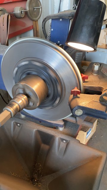

Ok so I had to check mine and same thing from the power stop pads. Now I’m wondering if I should switch back to the brembo pads. But that dust ugh

I actually resurfaced my rotors on my brake lathe and went back with brembo pads from dodge 5689F906-1410-4350-8FCA-C5CEEA3DF369.jpeg 4436B43E-514E-44A0-989E-3E1930255F6E.jpeg

Would you feel that turning them would be necessary before switching back to the stock pads?
My pads were due to be replaced so I decided to resurface them at the same time there wasn’t any warpage but hot spots yes and I actually wasn’t sure that they would turn out ok but they turned out fine
