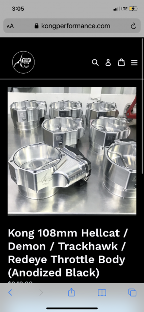

Kong Performance just came out with a new 108mm.
Any one hear good things about it?
My understanding is the Kong TB is the same one GHF is selling.
Ordered the 108mm Kong today. Last one in stock.
will see what happens.

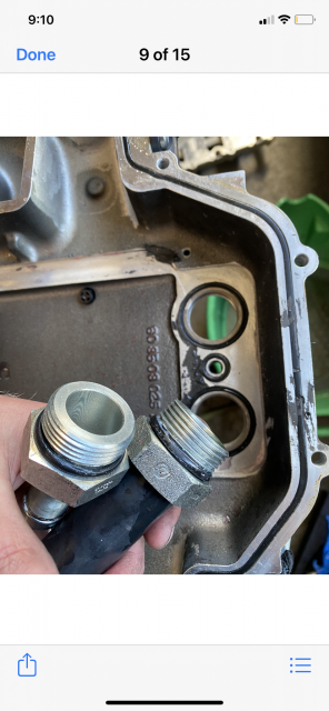

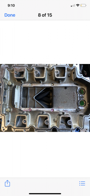

Well it’s been awhile since my last post and a lot has gone on. CA33083E-A892-4D46-AA25-CF33C8AFD9A2.png CA33083E-A892-4D46-AA25-CF33C8AFD9A2.png FC4D33EC-F7A7-4BD1-8A6C-C342138DC1DB.png 9ECE879E-321C-4FD5-A51F-27BA34489119.png 29A73E32-6EBE-41BC-817E-F36197394BE3.png BD0D9DE5-242D-4CBE-9746-A2E298A4225D.png 43664871-5B0D-4923-A0D9-91715778DD84.png Awhile back we ordered the Kong 108mm TB.
it finally showed up and shop took off the Vmp and ready to install the Kong. Tommy noticed coolant in the Magnuson snout as shown in the picture. Shop took the Maggie apart right away and found were the leak was coming from. The Maggie needed two new o-rings in the rear. Shopped around and could not find anything. Magnuson was 4 weeks out on everything back ordered on the 2650. Se we waited and still no response 🤦🏻. Then I found SuperChargers Online who specializes in Magnuson rebuilds. Took the Maggie to them and they inspected and rebuilt the SC with all new hardware and gaskets. That took 3 weeks but was worth it.

Maggie is back at the shop now and ready to install.
2nd...oil on the dip stick looked like a milky color and that means some coolant got mixed with the oil.. So now shop is going to do a engine flush a fresh oil change and filter.
I got really lucky. If Tommy never saw that coolant in the snout that morning I’d would have blown up the engine that day. We were on our way to the dyno to test out the new Kong TB. We dodged a bulliet. As of right now the car was never driven or had any strong pulls on the street so the block should be good.

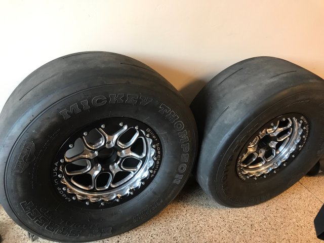

84817B90-9B02-4B63-9A5C-19B7FD0C7704.jpeg 3A3A0EF4-66F4-4DFF-BBE4-C029720EC399.jpeg 15 inch set up going on as well!

Getting the Stinkeye wheel package!! Mageye is going to haul ass now!! 😤

This thing is going to fly when it is back up and running!

QC issues on the Maggie or just sat too long or ? Hate seeing $3 parts that can ruin a motor. Kinda like the bolts that were falling outta the Whipples and taking out motors.
Yes agreed! It did sit for sometime. Tommy at the shop would always start it up and drive it a few miles every 2 weeks or so.
Not pointing the finger at anyone but for right now I’m not very pleased with Magnuson Super Chargers customer service and back ordered 3$ parts. It sat for so long because of the back order parts from magnuson. Also because of TB issues as well. The Magnuson it self I think is a great SC just some bad o-rings. It could of happened to anyone. Today Magnuson is 4 weeks backed up on everything 🤦🏻😬😡🙄.
Super Chargers online was awesome on the inspection and repairs. I know now it was assembled correctly and ready to go.
I did ask the shop to take a look at the oil filter when they change out the bad oil. Pretty sure all is good but doesn’t hurt to check everything out just in case.
