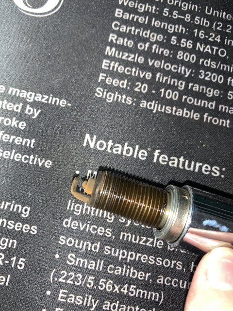

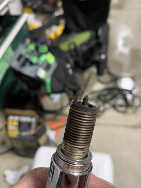

Thread Starter #429
76BDF900-D044-41CB-A7C5-7894EE12749C.jpeg 5A3F91D5-5037-4144-B5BB-DE90185A6250.jpeg
as many of you know I bought a tune for my car this summer. Well I had tons of issues with knock and fuel trims being way off on take off causing the car to be a little lean. Well I started tuning myself and I was fighting the tune A lot. Well I eventually made the car better I thought. But I’m guessing this plug has been bad for some time. Did the tune from the tuner cause this issue or was this plug bad already and it caused the issues to the tune I paid for. Idk. Not blaming anyone. Just curious. I bought the car used so who knows.
But this is cylinder 4 both plugs are broke as you can see. No misfire codes or anything. No idea. I can’t believe the car was running like it was. I had no signs a plug was bad. I just thought it would be good to check everything out over winter.
7,473
19,638
If misfire wasn't turned off in the tune it may not have been enough to register. I believe that's a pretty sensitive pid and will set a MIL pretty quick. It's possible that plug still fires, although I'd expect the spark to blow out under boost. Do you have pics of the other plugs?
I'd scope the bore. Something got hot but I've seen A LOT worse. You may have gotten lucky. Something like that "normally" means a lean condition, but I'd expect it not to burn the strap until it was in a decent amount of boost AND lean. The coloring makes me think it's been like that for a while.
17,290
54,100
I assume you're going to change out the entire set, no???

Thread Starter #432
cylinder mis fire is enabled. I’m thinking this has been a lot of my issues. My guess I bought the car like this a year and a half ago. From now on I’ll be doing a yearly plug check.
Cylinder 7 was the worst plug as far as color goes
Rest not bad

4,385
10,906
Thread Starter #434
I have new ones to put in. I’m doing a leak down test and a bore scope.
