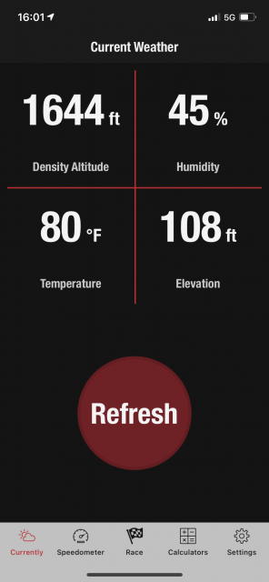

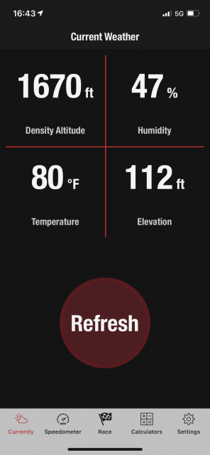

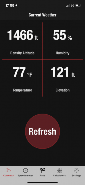

DA wasnt bad at all, however thats relative.
