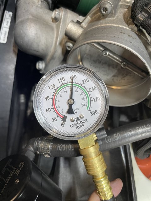

I'm done till the chiller comes in, in the meantime I'm going to do a compresson test and make sure the engine is still healthy.
A compression test is better then no test but your best bet is a leak down test as it will reveal even small cylinder sealing issues. A stock Hellcat engine will have very low leak down, like 1/2 to 1% even cold at 100 psi test pressure. With your IAT’s getting as high as they do your pistons are getting pretty hot which leads to allot of ring expansion, these engines are built with pretty small top ring gap which doesn’t allow much room for overheating before they butt. A Leak down test is the gold standard in cylinder sealing testing. A compression test won’t pick up 2-3% difference in leak down. A leak down test is something good to do even to an engine not giving any issues as knowing leak down figures for your engine and keeping track of them let’s you see a problem before it gets too out of hand causing even more costly repair when it finds you not you find it first. Excess blow by the rings gets them even hotter quicker which leads to ring butting even quicker. I think Speedy will even agree with me here, he knows where I’m coming from what ring butting can lead too.
You run a passenger side catch can? If yes what is it’s contents like after a track session? It’s good to start with a clean shiny can and see what it collects after a flogging at the track, good sealing will at hot engine temps will produce next to nothing in the catch can on a tight engine making very little blow by.
I agree with Speedy with Knock sensor 2 seeing the most noise, and it’s cyclical like it being generated by only a piston or 2 close together in the firing order, like 2 and 7 which are notorious for ring issues. Do a leak down test, it will tell you if you have damaged rings or not.

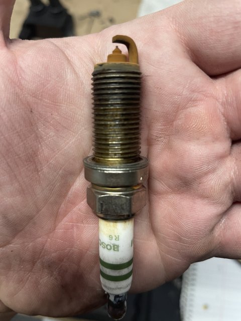

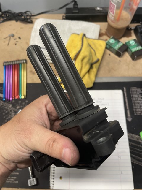

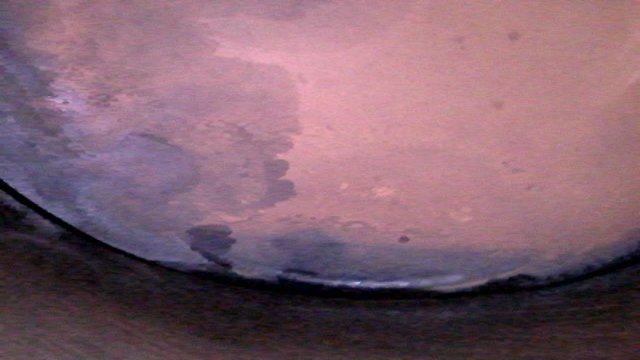

Kinda pissed, found previous owner ran boostane. Im in here and making it right. Gapping to 0.028 and she might be happier.
197B43B9-AA35-42C6-B0A8-A731BBB336C5.jpeg 1063942C-A55C-41EC-8C73-DE697BD26920.jpeg D84E8124-0C82-4094-B3D0-B324DADB3AD3.jpeg D6DF9BE0-8635-445C-8E32-B769610938DF.jpeg 1F7D06AA-1724-4AB9-842A-764201A46447.jpeg 33CD4B01-EB28-4D03-928B-217BBDB9CC9F.jpeg
I have only ever run 93 and 104 in the car. Cylinder 1 done. Seven more to go. 💪

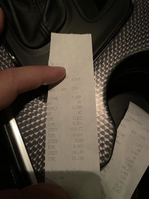

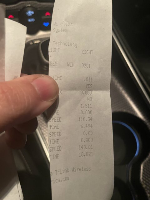

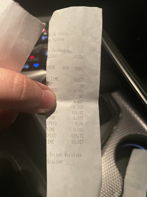

Just got home, she ate. Prep was not the best. Had fun with the homies and had a grudge with a Mustang. He didn’t expect it…
First hit, conservative timing compared to final tune, knock sensors desensitized. No knock in the logs.
Spun, this tune had all the beans. The backhalf got me rock hard in the pants.
First grudge with mustang, we both red lit. All the beans and still no knock…
We ran it back, still took the W!
The car has a 9 in it for sure. The prep wasnt the greatest and on the last run there was no prep at all as they wanted to run the lanes out.
Strangest anual probe I have seen cents I left Costa Rica in the 70s. her name was Ann U Ail. What a gap. Kinda dirty.

Heck ya! If I remember right that is your best mph so far. You’ll be in the 9s no problem!

Man your SOOOOOO close!!! Good to hear no knock, I’d be inching the sensitivity back towards your original numbers just 1-2% at a time until you start seeing it return then go back up 2%. That will get you at a very safe spot. Get the 60 down just .05 and you’ve got it no problemO!!!

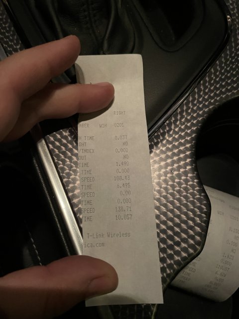

Damn Fuman, your close, nice mph, I think with no knock or timing being pulled got your ET down. 60' still good but a little better will get a 9, 3.09 + 315 LOL, what was DA & humidity ? ..I like to see DA info to compare to previous passes when you ran 10.0's & teens. If DA was lower than b4 it should pick up some, if not or the same then you have true gains.

Instead of messing with the sensors as the no muffler, no resonators and higher pitched pulley wont' go away, I'm putting the timing appropriate for 93 gasoline. It' doesn't feel sluggish but it doesn't pull like a freight train. I am also not running anything other than BP 93 as it's the only gas I trust around here.
I have to look at the weather data, I'll get back to you on that. I think I did capture a lot of it off TRC app that night. Was busy reviewing logs and making sure knock was no where to be found.
Keep chipping away , you are almost there .
Almost, lanes still sucked. So many cars and with open session it's hard to get a good start. Even with the good start the prep wasn't there caues it was the end of the night.. 😐
