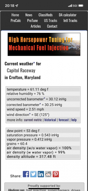

Finally collected all the data. Although DA went down, Humidity and grain size shot through the roof. It was really a fight against time.
Can't wait to have an interchiiler so even 130 IATS are not a thing.
Oh man, I can't wait for some DA like that, very good. The humidity was getting up there on last 2 passes, that's the bad thing about racing into the night vs during the day.

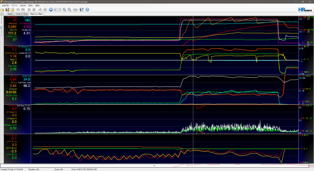

So here is why I need an interchiller. At the start of my run, I'm at 111.2* by the end of the run I'm at 135*. This is unfortunate because the car is unpredicatable. If you have a chiller of sorts you can maintain a cool temp up to and until WOT. Here is my fastest pass of the night. 10.02 @ 140MPH. Imagine not having any timing pulled cause of temps and being able to hot lap the car if necessary during a competition.

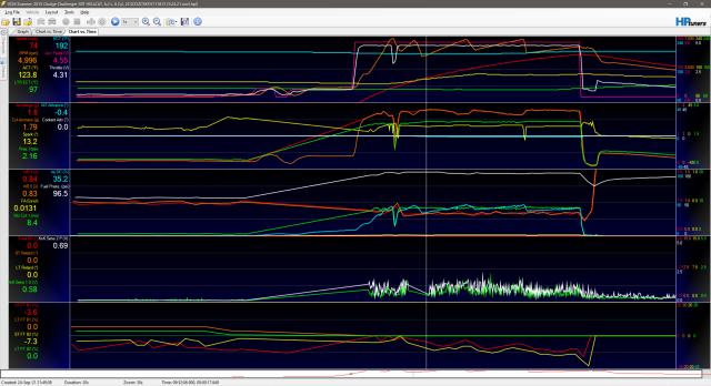

On the last pass I spun. Here is the log, see the dip in the speed.

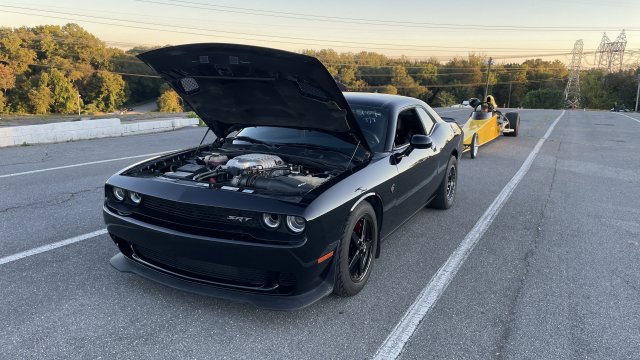

LETS FUCKING GOOOOOO!
AA47CC32-A4A7-434A-9BF6-3BD27D82C70A.jpeg 2E99D1A4-E694-435B-BF93-B15A33FF004F.png A24F1EAE-A16D-45E7-A297-CD38884C2AB2.jpeg
7,491
19,690
Hell yeah! Welcome to the 9 second club! 143 mph is smoking
