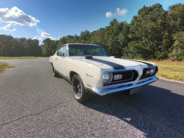

I used to love a manual but the A8 is so awesome, I don’t miss the clutch one bit. My 69 fastback Cuda still has the A833...but I don’t drive it much. View attachment 9374
I have the same car A-833 4spd black interior , right down to the same Hurst shifter. My 22 year old son drives it everywhere. I can't get him out of it ! GOPR0184 (1).JPG GOPR0184 (1).JPG

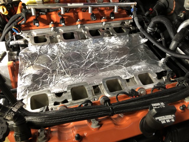

I like the heat reflective material on the coolant tank. It has always bothered me how such a high heat source is
located so close to the airbox. I have the same type of material ( Summit ) and plan on applying to the air box it's
self, now maybe the tank as well. Has it made a noticeable difference in your air intake temp.
3,828
9,071
25A9D3FC-D478-4412-8B35-E722BCF6F321.jpeg 3CFCB611-902E-4670-97DA-B8CD9BAB99F3.jpeg Yes, insulating made a difference in IAT’s, coolant temp is usually about 7-8 degrees over ambient. Under the reflective sticky back is 1/4” insulation sheet, and the JLT air box, the throttle body inlet tube, blower spacer, double insulating blanket between engine and blower, all Coolant lines and the Intercooler pump will be insulated as well.
E70BCFDC-4A75-4D83-B1AC-647E9CB6190B.jpeg 577ED235-0171-4027-90CB-92ECC3DDDFA1.jpeg

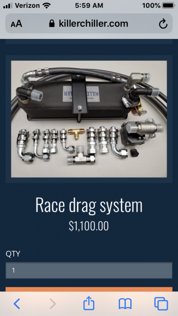

Nice ! good info, I like the whole package. Are you going with the Kincaid Killer Chiller?
3,828
9,071
Yes, the bigger drag version, along D1187BAB-F355-4852-8124-5AD834DCC0B6.png with intercooler bypass and a 1 gallon cold water hopper tank under the washer bottle
