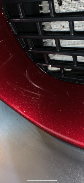

Update: I spoke to the service manager and walked him over the car and all the issues I had with the install. Emailed all my pictures to him too. He's working with the installer now and should get back to me this afternoon. The dealer is leaning towards letting them fix it as they have a good relationship with the installer. I will insist on a computer-cut piece of film if they do and probably try to be present for the install.
Also, luckily that picture or the rear quarter just captured a piece of lint or something and there is no scratch from a knife mark in the paint. That said, I'm going over every inch of it now looking for any...
At first I wasn't going to get bent out of shape about it. The nose of the car is *mostly* protected after all. Now after reading your comments I'm fired up and want it perfect!

When I purchased my 2019 Charger I had a front wrap of PPF installed. Bumper and half fenders/hood. Paid 1100 for it.
When I picked up the car my heart sunk to my knees. It just was not what I expected at all. The film was cut oddly on the lower front spoiler and several large spots were not protected at all. In addition, the film ended several mm away from the leading edges across the whole install.
My question is, for those of you who have had PPF added to your Charger (Hellcat/SRT/392), can you post pictures of the details? Here's some examples of what it looks like on my Charger and I'd love to put my mind at ease that it's normal for the amount paid or if I need to go back to the installer.
Thanks!
View attachment 4557 View attachment 4558 View attachment 4559 View attachment 4561

Did you get FULL hood and fenders or just a section? The price you paid is an odd price and most prices are pretty uniform across the board, 6-800 for mid hood, fenders and grill, or 15-1800 for full hood, fenders and grill. Some shops don't wrap edges, especially if using plot cut films. Edges are tricky and even the best cleaning beforehand can keep an edge from laying down, then it peals then you're hosed. So by going up to 1/4 to the edge you may have better luck on the material staying down. Either way, yours is pretty bad, and if the shop has been around that isn't good.

I think you've figured by now it's not right, but I'll add it appears to me the installer didn't use computer cut sheets for the vehicle nor did they use a steamer to mold it in tight places. I have a video of how mine was done on my channel and it's dang near perfect.
$1100 would be a fair price assuming paint correction was performed as part of the labor. If not I'd expect it to be 40% less.
