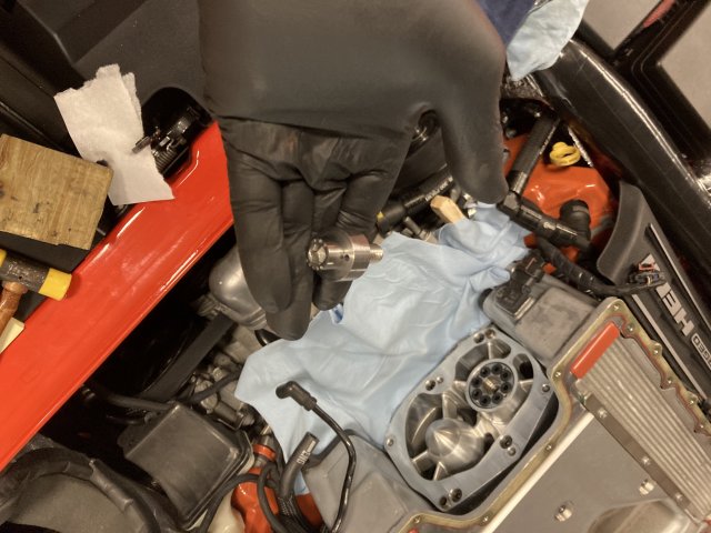

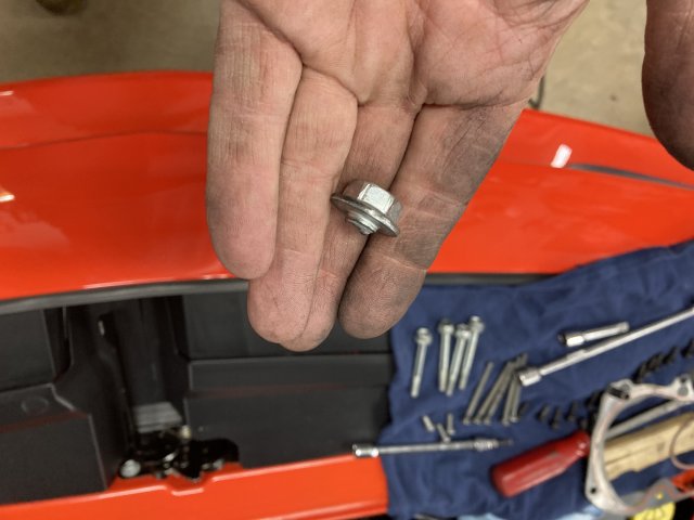

Here’s what I found when I took the snout off. Luckily the rotor shafts are harder then the coupling hub and rotor shaft survived, new coupling from Bond was like 70$, and their not new!! Their take off used ones!! And the coupling inserts are $10 each, what robbery!! I’m making them myself for next time, their just black Delrin.

FYI, not all Delrin is created equal.
the quality of Bonds bushings for the price is robbery, I could spin out better more accurate parts on my manually operated little lathe. I’ve cut allot of delrin in my days, there’s nothing special looking of what bond is using. We’ll see how they hold up. I’ve got other material ideas now since if got them sketched now to make some.
