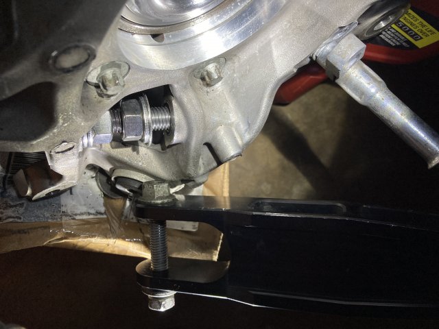

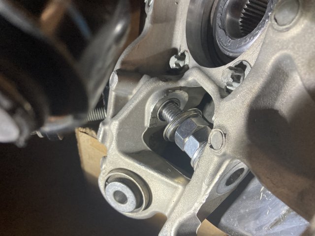

In installing the axles I tried a new technique that @jonx96 suggested to me to try, using a bolt and nuts to push the bushing in the lower knuckle in out of the way instead of the crude didn’t seem right hammer and drift method I was using. MUCH easier and effective!!! 2 wrench turns on a nut pushed the bushing flush up against the spindle body allowing the spindle to drop right one the lower control arm and effortlessly align the holes to slide the bolt in place. So I figured I’d share the technique will all who have been keeping interest in the continued adventures of GoManGo lol.
I used a M14x2.0x 85 mm long socket head cap screw and used a die to fully thread the partially threaded grade 12.9 socket head cap screw, then added 2 nuts and a few washers.
Slide the bolt in in the same way the original comes out, add washers, 2 nuts, 2 more washers and thread them up the bolt until the bolt can align itself into the other hole in the spindle. Then with 2 M22 open end wrenches (or 2 adjustable wrenches), hold 1 nut in place, turn the other about 1 full turn and the bushing is pressed flat into te spindle totally out of the way!!

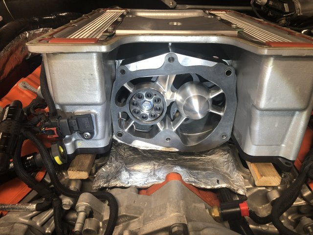

Here ya go. Yes, a solid 50 hp. This on 93 with a can of Octanium per 15 gallons of fuel. 2.85 upper stock lower. What was added was the FAS billet plate, port matched snout to plate inlet and opened up inlet to match a Fastman modded 95mm TB
Little to no change in IAT but I run a chiller. Only increase in IAT I’ve seen is since I’ve added a +10 lower and stepped down to a 2.72 from a 2.85. The better breathing can be seen from 5500 rpm and up.

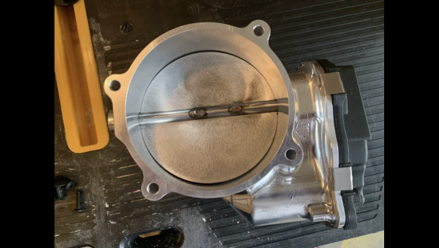

This weekend I’m hoping to dyno test a change from a BBK 100 TB to a HHP 105mm TB. Being that my aircharge is up allot now after adding the +10 lower and 2.72 upper might be restricted some by the 100mm valve. Hopefully we will see Saturday, HHP TB due to arrive tomorrow. I’m really anxious to measure the blade diameter and see if it’s a true 105 or not, the inlet and outlet taper seen in pictures makes me wonder. Stay tuned!!

Ok, the results are in, BBK100mm verse HHP105mm throttle body. Same snout which is opened up matched to the 100 mm TB outlet, ie with the 105 mounted there was a 2.5mm lip restriction all the way around the 105’s outlet. So what was the result? Did it make more or less HP? If more how much? if less how much? or the same little to no difference?? Dyno pulls done within 10 minutes of each other, IAT and critical temps pretty much matched. All was done is a baseline pull, swap in the HHP 105, do a throttle relearn, and hit it again. DA was around 4300, ya, pretty yucky. Sooooo what’s the opinions?? This ain’t for free no more 😂
