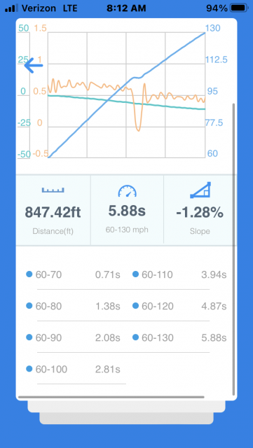

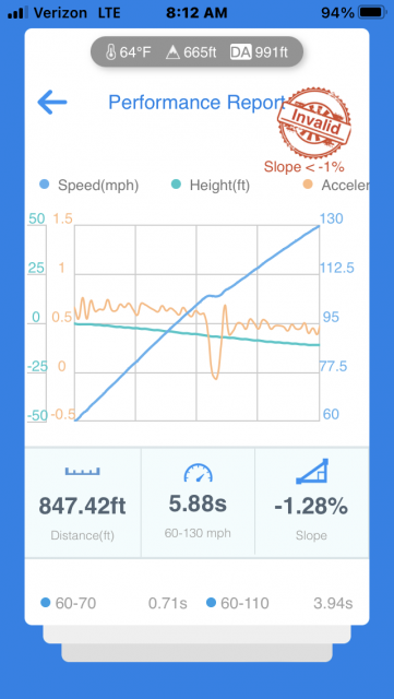

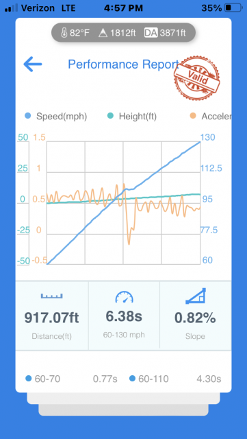

A run this morning. Take note to DA difference. The slope I’m surprised at as it was the opposite direction on same bridge, albeit I started a bit later across the bridge, had to let traffic get way ahead for a clear road.

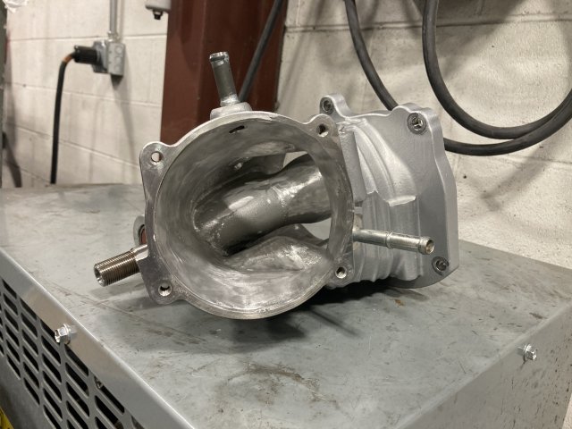

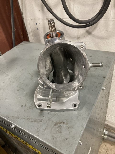

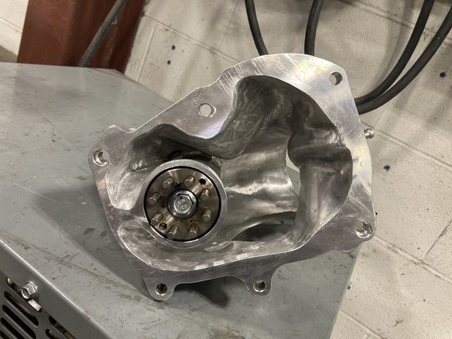

Anyways, here’s the home hand ported snout ready for later. Look at the mouth on that thing!!!!
B1968A6A-532C-45D5-AC3C-2C09D9290620.jpeg 89517DA1-55C1-4C2A-B4ED-72C1BDB2BC19.jpeg F802D1FB-EF0C-4DDB-A1E0-08818D390DF5.jpeg E994991B-33E9-4838-B488-FE08A745A577.jpeg
It’s opened up for up to a 108mm TB and port matched to the Billet inlet plate. ALLOT of material came out of it, I should’ve weighed it before and after but it’s like a feather now compared to when I started.

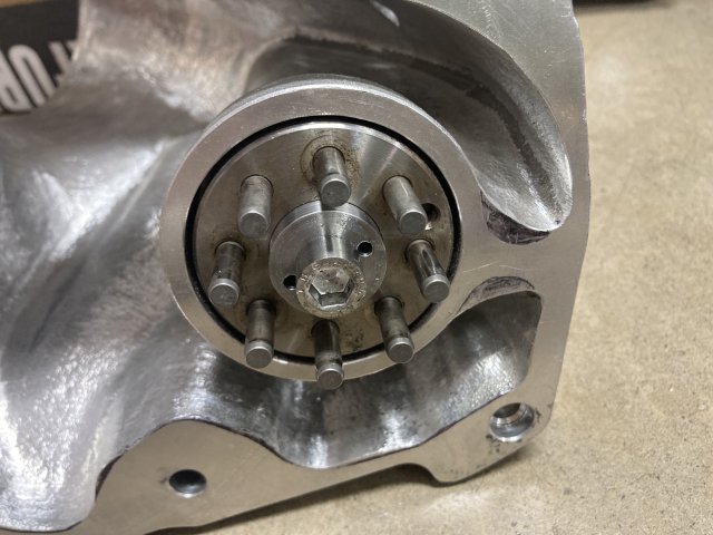

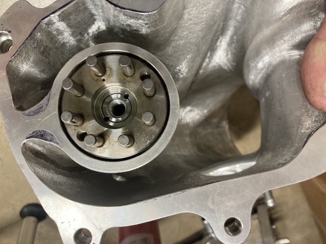

I pinned the coupling too.

I wondered if pinning the coupling would allow for pulley changes without removing the snout? Would still have to hold the rotors still somehow but wondering.

Unfortunately no, still have to hold the shaft from Turning somehow to break the pulley loose from the shaft. Jokerz makes a quick change shaft that has a hex in the center on the front so you can hold it that way but getting them broken loose with that set up sometimes it’s impossible especially when you’re driving them hard like this. The torque spec might be 60 or so ft pounds to put it on the shaft but once the motor turns it it’s probably 150+ Ft pounds to break them loose!!!

It’s not as smooth as it looks in pictures, not as smooth as CNC porting I’ve seen, that’s too rough if you ask my .02.

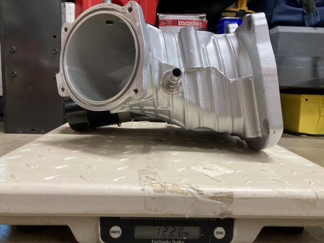

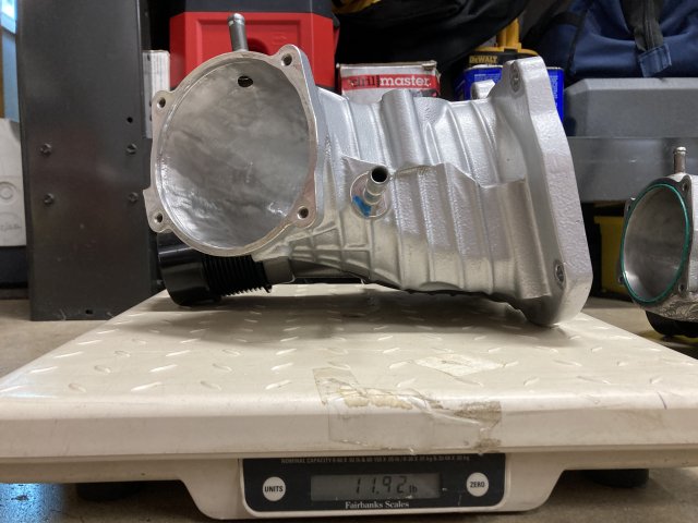

So I got curious when I got home being I have a brand-new snout with a 272 pulley on it m, my other snout with a 272 pulley on it, and this snout with a 272 pulley on it so I put each one of them on a scale. And low and behold they all weigh about the same sort of. these vendors that are saying they take pounds off of each one maybe they do but look at the difference in how much material was taken out of each one and look at the weights and you judge for yourself. I have to call bullshit on their claims. 7D1B356B-DCE0-4934-948E-D7D8199E591B.jpeg EF4B7A3B-C213-4A6C-9ED4-37732899FD95.jpeg E5CC7324-5803-498F-BB94-D3CC96F8A78B.jpeg CD886229-1385-4244-B08E-710932821A83.jpeg
1,596
3,983
data don't lie. Al is pretty low density, so the pile of removed chips & shards may look impressive, but it don't weigh much
4,622
9,573
Chances are, most of the material on the inside that can be removed - has been. The majority of the weight is the shaft, pulley, exterior webbing, and the thick flanges. Losing a pound or more wouldn’t necessarily be beneficial to airflow because it’d probably be removed from the outside of the snout.

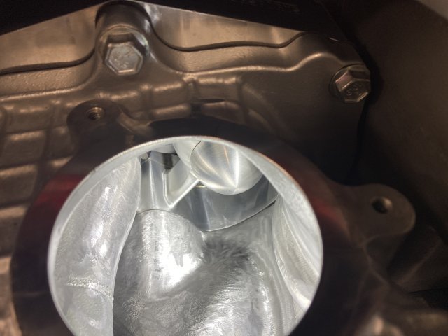

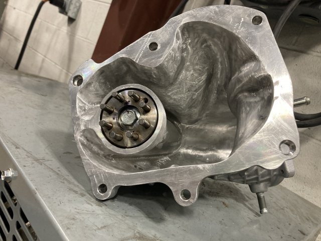

All the parts have been here since Wednesday but Work has left me to beat the last two nights To even work on my favorite task. Hopefully put a run in later tonight when it cools off. This is what a port match snout to a billet plate Inlet plate looks like from the inside. The area around the driveshaft housing was greatly opened up allowing that wrote her to pull in much more air it’s hard to see on the left side.
