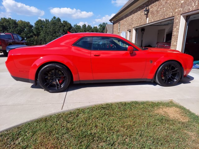

I got mine past 1k miles. Still no check engine light. This is a welcome change as both my RE's had the light on well before now. Of course, I probably just jinxed myself. lol
Here's a pic of my ride 20" around wheel/tires..
Car looks amazing. I can't wait to see it run in a few months..............
