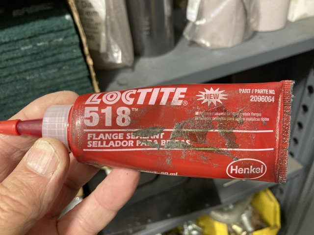

I just tighten them by feel for bolt size. If you want to find a true torque spec just look up the torque spec for the thread size in a button head and use that. But yes I use blue Loctite on them they don’t have to be overly tight but yes you don’t want them to come loose either lol.
The anaerobic sealer that I use is this Loctite stuff works great doesn’t Hardin until made it and you wipe off the excess that squeezes out and it makes it perfect seal.
