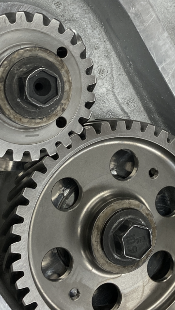

Agree, if you saw how rotor timing is held in place you’d wonder how that survives too. Think of the damper pulley but only as big around as an index finger but spinning 33,000 rpm and only half on by a 10mm LH thread grade 10.9 flange head bolt. No KW, no pins, no splines, just clamp load from the bolt just like the harmonic damper on the crank shaft. But at least the harmonic balancer is a tight press fit onto the crank, that gear is a slip fit onto the rotor shaft

Nope, it has a little ring that squeezes between 2 faces, not even a taper lock kind of lock up, just face to face clamp load. I put 680 lock tite in there and be quick about getting timing right and lock it down with an impact. Never had one move after that. I’ll post a picture in a bit of it, Have to find one on my phone. I posted pictures of the area before it’s probably in that thread that speedy posted a link to earlier in this thread

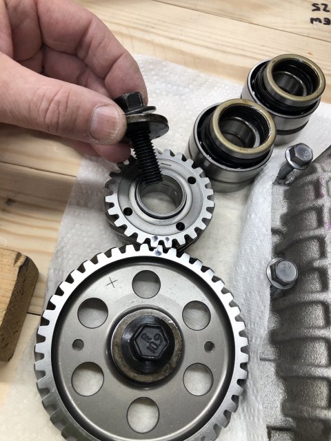

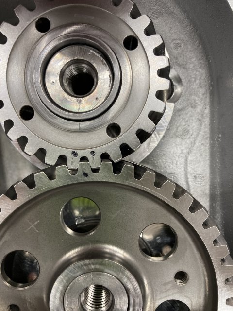

This little ring sandwiched between bolt and gearbis all that hold the faster gear on the heavier faster spinning rotor in place. And has to keep this .006” cold gap, which probably closes to .002-.003 when the rotors are hot, from touching. They get out of time just a hair and they start rubbing the coating off first, then comes aluminum if they get further out of time and then they start getting hot quick and then lock up against one another and blow the case apart. The weaker 2015-2017 cases with out the cylinder separating ports fail first as they are very thinly casted.
9549EE00-7EBD-4254-AC20-736A3B68867F.jpeg 5300B295-3F8C-4232-A38F-24F12DF0B39B.jpeg 4262B8FE-19EA-44EF-B950-68878A9BEEB4.jpeg 65AE31D5-58AD-4DB5-B0FF-34F6A35B2847.jpeg BACE01A6-2644-4AE1-93DC-62BADC36338D.jpeg 6A38B8FB-8B70-4710-ADCC-A280DF405731.jpeg
View attachment 74566 View attachment 74567 View attachment 74568 View attachment 74569 View attachment 74570 View attachment 74571
The actual clamp load is the flat washer on top of the "Spacer" bushing that holds the spacing, I agree that it is a tremendous load for such a small bolt to hold with that kind of mass and inertia...I personally would use a 12.9 for the added insurance.
That’s precisely what I do, I upgrade all bolts to 12.9’s but finding a grade 12.9 Flange Head LH thread bolt center drilled and cross drilled is impossible. This is a pretty special bolt. The blower gear case breaths to atmosphere through this bolts center.

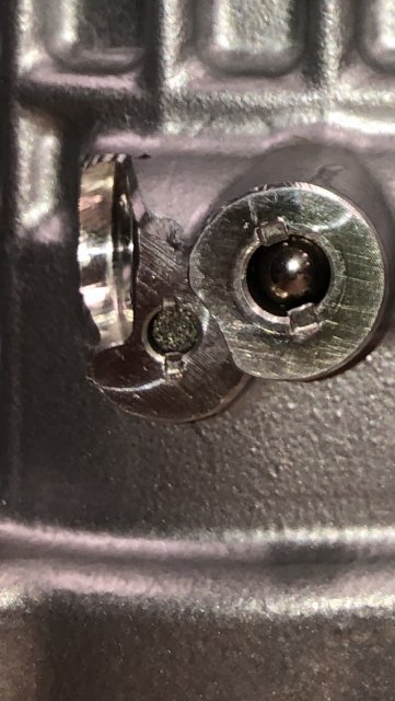

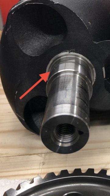

See the funnel shape leading to the hole in the bolts center? Centrifugal force at 25,000+ rpm separates any oil in the maelstrom of swirling oil from getting out the hole but air pressure differences can. It leads to the hole in the shaft pointed out by the red arrow which leads to a chamber between 2 seals that leads to the 2 vent ports on the underside of the blower. (Not the shinny ball, the porous looking things to the left of the shinny ball). These are the things that you don’t want to cover up when you put a blower blanket on the bottom, cut little slits in the blanket so these 2 ports can breath
13866414-A74D-4B11-BEB0-705DFF0367F5.png BE2F0A55-AC8D-47FB-AF28-DDA49929C24F.jpeg AED817AB-0BF2-428A-9820-222E1B4B9CB8.jpeg
View attachment 74723 View attachment 74724 View attachment 74725
