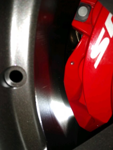

So im wondering how tight the wheel/brake clearance actually is. Considering how many people swap wheels around my concern would be that ’20 and down wheels might not clear the ‘21 brakes if someone wanted to switch out to maybe an older style oem.
I've got you covered on that one Slowpoke. I have a cpl of the stock Devil's rims from the '19 laying right beside the '21 so I stuck one on just to see. Plenty of room.
