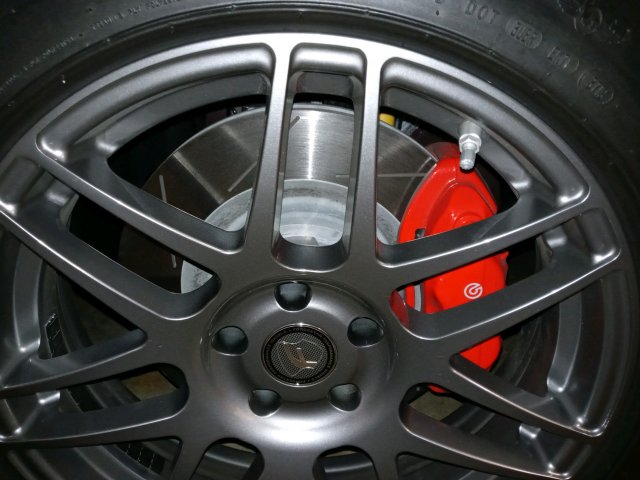

UPDATE:
Last night went well.
I was able to do a thorough re-bleeding of the front brakes. I let them gravity bleed for several minutes and then did the typical pressure bleed a few times after. I got zero air on the pressure bleeds and the pedal is a good bit better. As would be expected, the 4 piston 14 inch rotor setup isn't nearly as strong as the 6 piston 15+ inch rotor setup. It's what I'd call sufficient by comparison.
We were able to get to Music City. I made 4 runs in pretty rapid succession. The car ran notably better. It's quicker and faster at every measured interval. It ran 147-1.48 sixty foot and 6.74/6.75 eighth mile et on all 4 runs. The mph is what I'm most happy about. Two weeks ago the 6.90's were accompanied by mph of 100/101. This weeks 6.70's were accompanied by 104/105 mph. Not bad for a full weight car on a Tuesday night prep. For reference the DA last night was around 2000 ft during the time I was making my passes. There was a cold front coming in that had rain in it so we didn't stay for the cooler air for fear we'd end up an hour from home in the rain with those ET R's.
It's nice to see the car acting like it should.
I'll be ordering the AAD arms and BMR cradle lockouts shortly. I'm going to go ahead and get the BWoody shorter sway bar links as well. I've never had an issue w either car when running the 17" wheels on the rears but if I have to spend a bunch of time under it installing the other stuff I might as well put them in while I'm under there. Hopefully I can get the stuff in a decent timeframe and get back to the track with that setup before the hot weather gets here for the summer...

I was hoping for some better DA but the good air came in along w some pretty ominous looking clouds, so we aired up the tires and got the heck out of there. I checked the DA when I got home and it was 1100 ft. I really wish we could have stayed another hour. I'm guessing I might have eeked out a .60. It had already run to suit me and I SURE didn't want to get caught that far from home in the rain though.
It still shifts HARD. It rattles the tires on the 1-2 shift every time. It feels just like that vid of your car looks. I'm thinking I'll get the rear suspension stuff replaced and get the tires where they actually sit flat on the ground across the tread and will go back to see if that helps it not rattle like that. And then go from there...
Worth noting is that the brakes work and feel "right" now but it flat won't hold at 2k rpm on the line. All I can get it to and still have good enough stopping power to bump it into the 2nd light is around 1700. It's not that big of a deal but it does have me wondering what else is different between a big brake car and a little brake car. A proportioning valve maybe?

I think you might be onto something. Because I had no issues getting to 2100 RPM or so. But, you have a converted car. Not all OEM. The only thing I will ask is did you use OEM Pads? Which ones? Not sure if there are even different ones to choose from.
All front brake/knuckle components were spec'd for your car.. 2020 SS. All stock Mopar stuff, incl pads. FWIW - I saw a 1320 at the track last night and it has the same stuff on it.
I'll be looking into the proportioning valve idea tomorrow.
