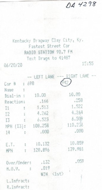

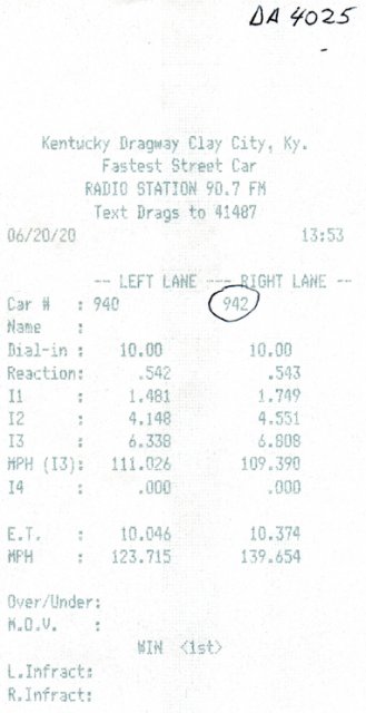

Well, the difference between the two slips below was only 2 deg of timing from about 3,000 to 5,000 RPM. Took out 2 deg and didn't spin, so it's definitely a fine line but I want low 1.4 high 1.3x 60s that I know this car is capable of.
View attachment 20288 View attachment 20289
I've started playing with timing down low ( 2000-3000 rpms) to get lower 60's and better traction . I only got one 1.39 sixty foot so I wanted to replicate it . Unfortunately if the track can't hold the car I have been pulling timing out . 1 degree makes all the difference but unfortunately the 60's will suffer .
I'm hoping this weekend if the track prep is awesome I will test a few different tunes and get some data to share with everyone .

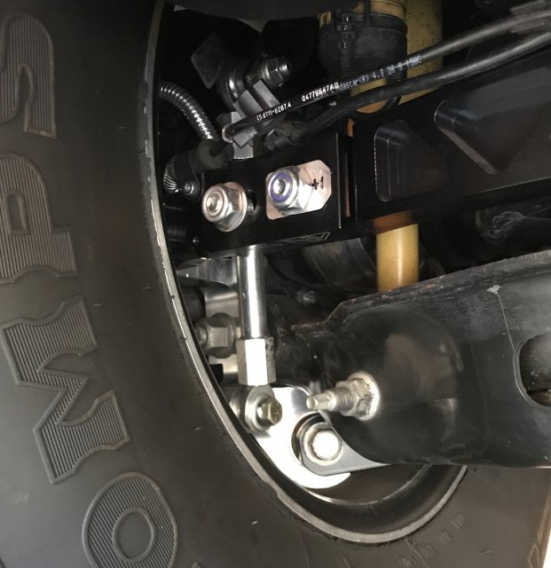

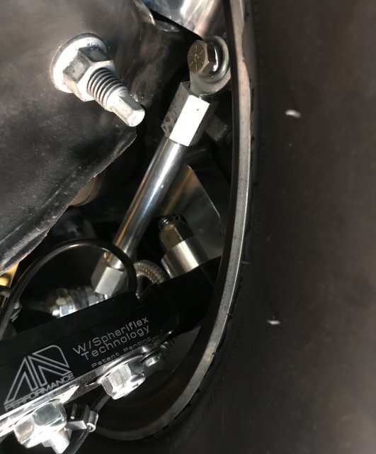

You can get adjustable end links. Mine are Carlyle. I have their 15” conversion with the billet spindle that requires a really short link. I haven’t measured it but it is REALLY short. Adjusted to fit, it doesn’t hit my AAD arm. 76CEEAEC-18CC-4558-BBE7-EDC98CD9F4A5.jpeg 7D6EF3DC-2FC9-4A96-A7D9-792659013A46.jpeg

Usually its seen on 15" kits and arent aware of it happening with a typical shortened link on a 17" package...according to Zach anyways:
"To touch on the sway bars hitting our arms with shorter endlinks. I have seen it 2 times, They were both on 15 inch cars with very short sway bar endlinks. If you purchase shorter sway bar endlinks with 17s it should clear no problem!!!"
That's just not what we are seeing lately though...so there must be multiple contributing factors that we are missing. There's definitely something happening though.
