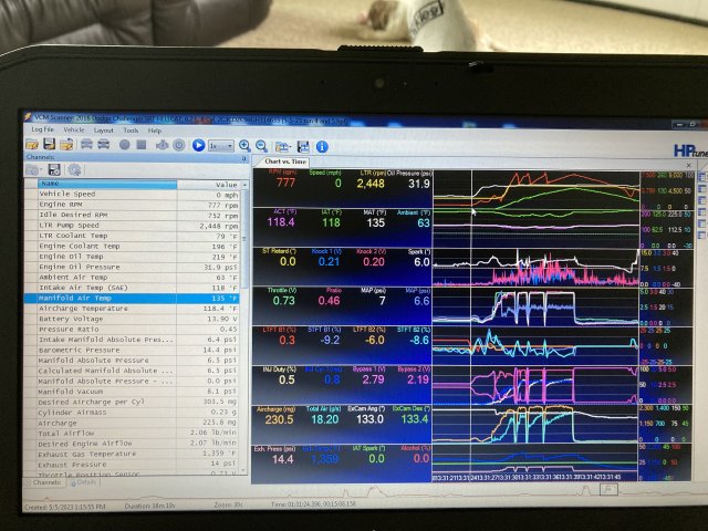

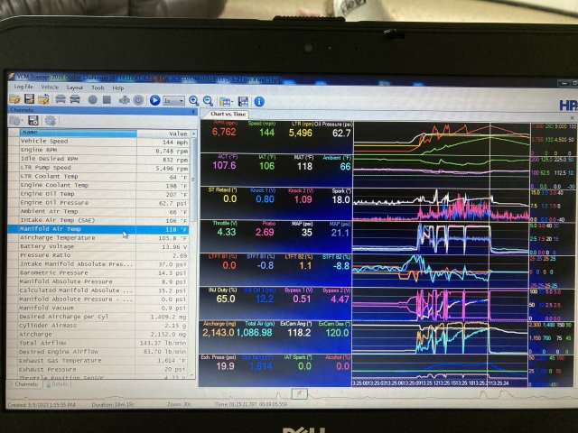

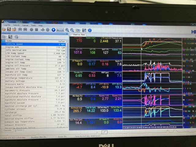

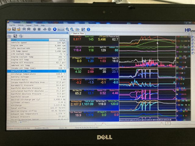

I just emailed you a log from @vortecd car 3.0 upper stock lower. Was in the 70s day of the log
holy shit that iat stayed below timing pull even with a 118* start. Thinking of getting rid of my ihi now. 3.0 + ic chiller would be nuts…
They do better than the ihi as far as temps. He has the whipple intake as well.

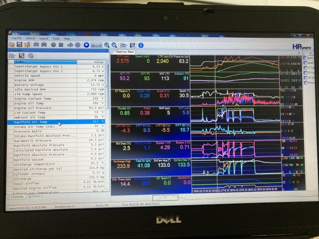

Here’s the 3.0 back to back 1/4 runs last month
D43C24B1-E6AC-414E-B5C9-BF5EA584D656.jpeg BBD6286F-9206-47EC-9BDF-7DD3BA06EBDA.jpeg 829D9768-C267-4A76-B377-2ACCA3FBBCBF.jpeg 77578986-9199-450B-8659-C5D5F73119B5.jpeg

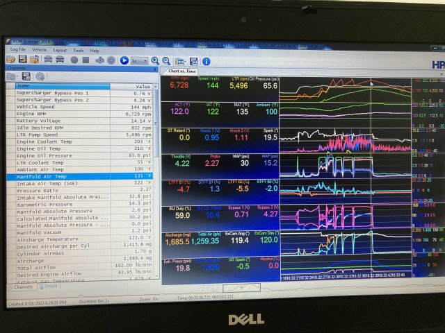

Here’s the 2.4 2.72/+10 combo, yea, it got IAT timing pull hot by the end of the 1/4 but it was 90 F ambient that day
1F8F87B8-6EA5-46F4-9F4A-711F9DDB771E.jpeg AB79EA4B-29F7-4EC5-8D89-0399D709F15E.jpeg
I only run E80-85, no more 93 for me so the Whipple fits the bill but Whipples start rattling wayyyy too often.

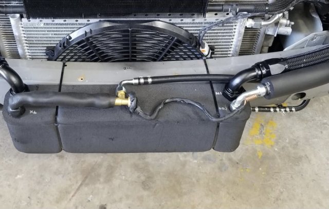

I am not running a whipple but i AM running an IC Chiller and Bumper mounted Res installed by Allpar Garage this season.
IAT's are no longer an issue and it's nice. last year even with the BMR box it got TOASTY.
We'll see how good it does when we drop to the 2.50 next time out.
