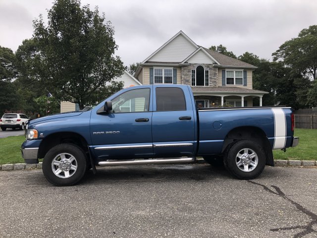

Does that include diesel powered trucks? I’d have to doubt it. Hopefully. Closest to the house sometimes its in the driveway, otherwise in the street. My CTD is almost 20 yo so whatever…

Oh fu**! Naturally I didn't read it and assumed gasoline. Meh, whatever… Ive got 266+k on my old gal, but whatever….
PS, is this admission admissible in court? Like I care…I was hoping to ride this truck into retirement, but whatever…Power Wagons are nice!
